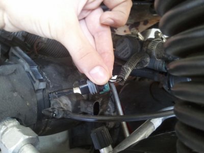

hey guys just a quick question for you. theres a valve on the engine bay side of the firewall connecting to the heater core hoses which is supposed to at some point cut off hot coolant to the core. this valve is actuated by a solenoid that allows vaccume to flow through a tube directly to the valve. my solenoid appeared to be not working but when i unplugged the wires and put a volt meter on em.. no change in voltage no matter what the climate control is set to.
Ive been having trouble with my hvac unit in the dash for example: no change in voltage to recirculation door motor, erratic voltage to blend door motor.
would no voltage to this solenoid be caused by a faulty hvac control unit?
the plug im holding in the pic is what has no voltage

It's more then likely the in dash unit, it could be a chaffed wire but since none of that junk works probably not. Perhaps something is unplugged back there??
