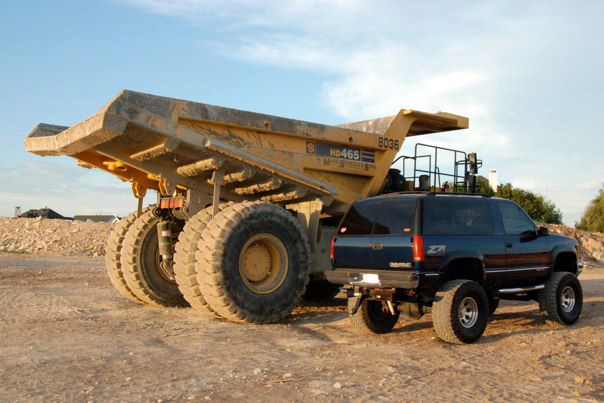

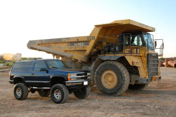

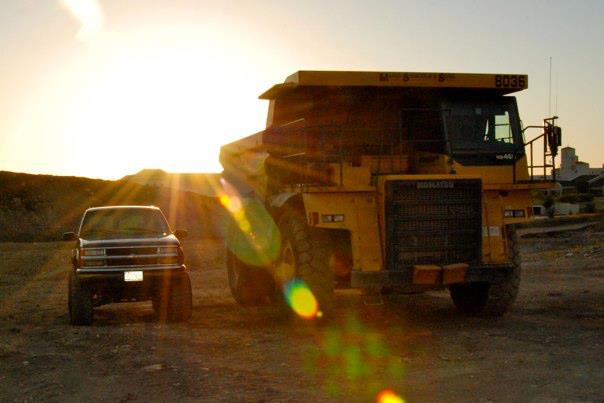

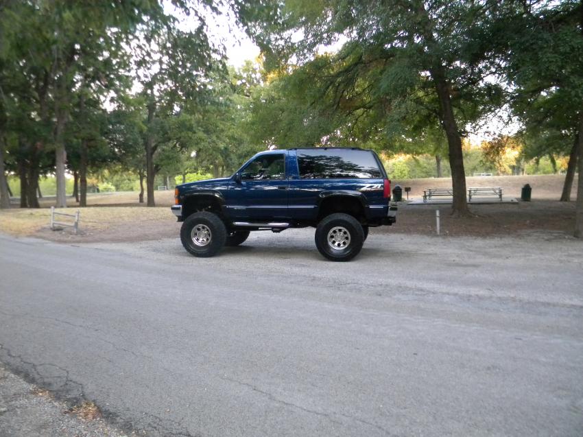

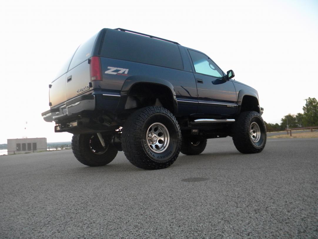

This truck is woking in my neighbohood and thought I'd shoot a couple of pics.
The Tahoe has 11" of lift on 38's.

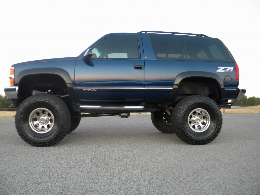

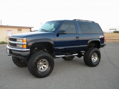

The Tahoe has about 11" of lift total
• 6" Pro Comp lift up front with the torrison bars cranked a little
• ball joint flip
• Pro Comp 4" rear springs
• 4" blocks in the back
• Pro Comp Shocks
• 3" Body lift.

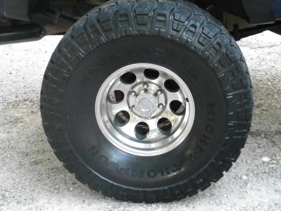

• 38" Mickey Thompson Baja Claws
• 16 x 10 Pro Comp wheels
• 14 Bolt SF rear diff
• Built Transmission w/trans cooler
• Dual Exhaust
• Air intake system
