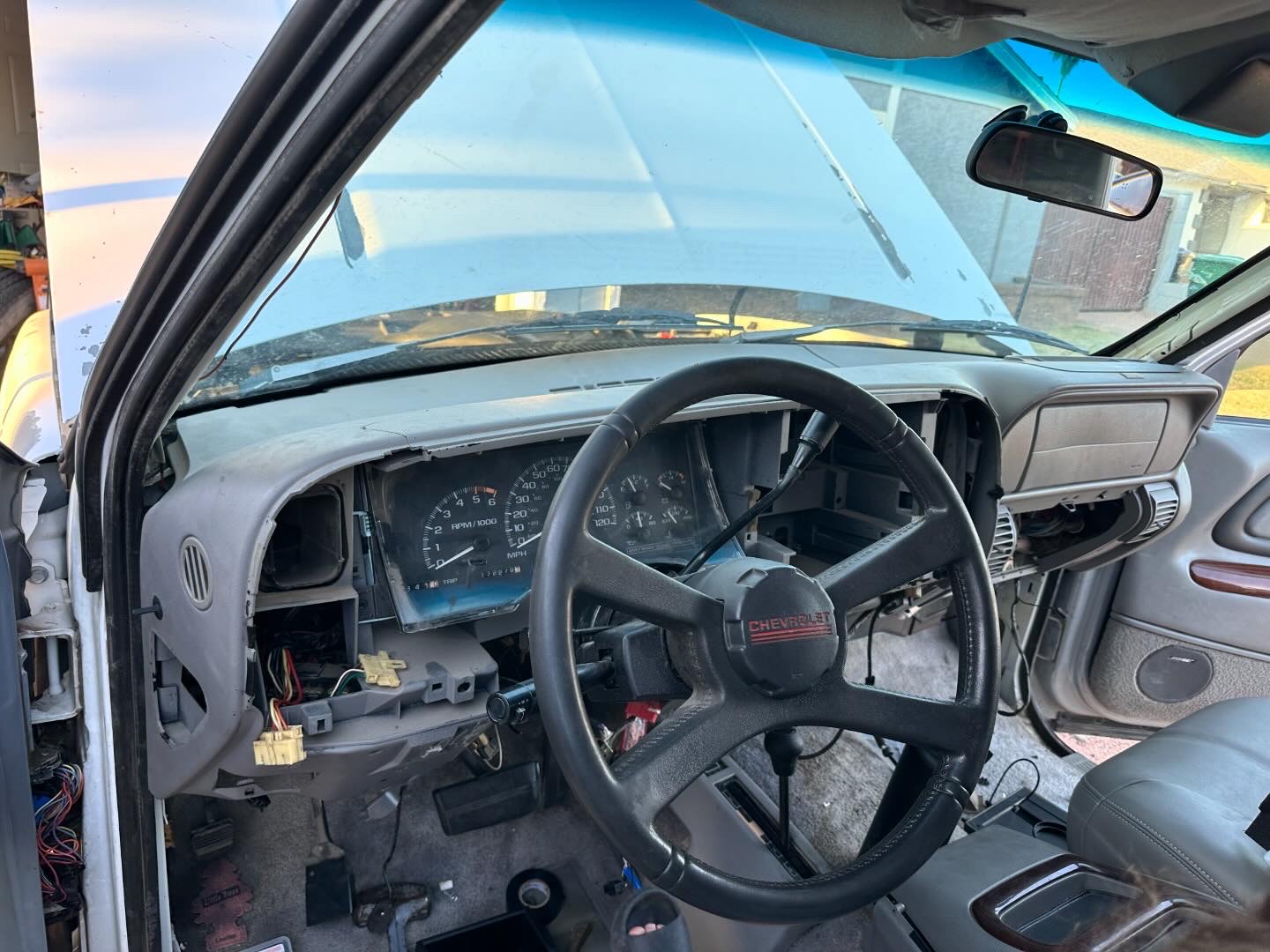

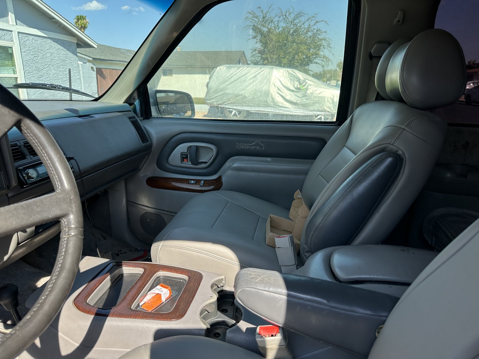

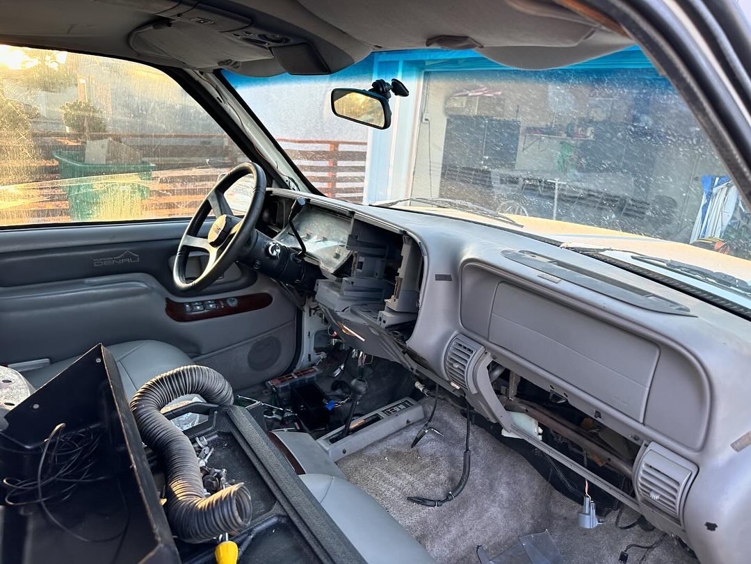

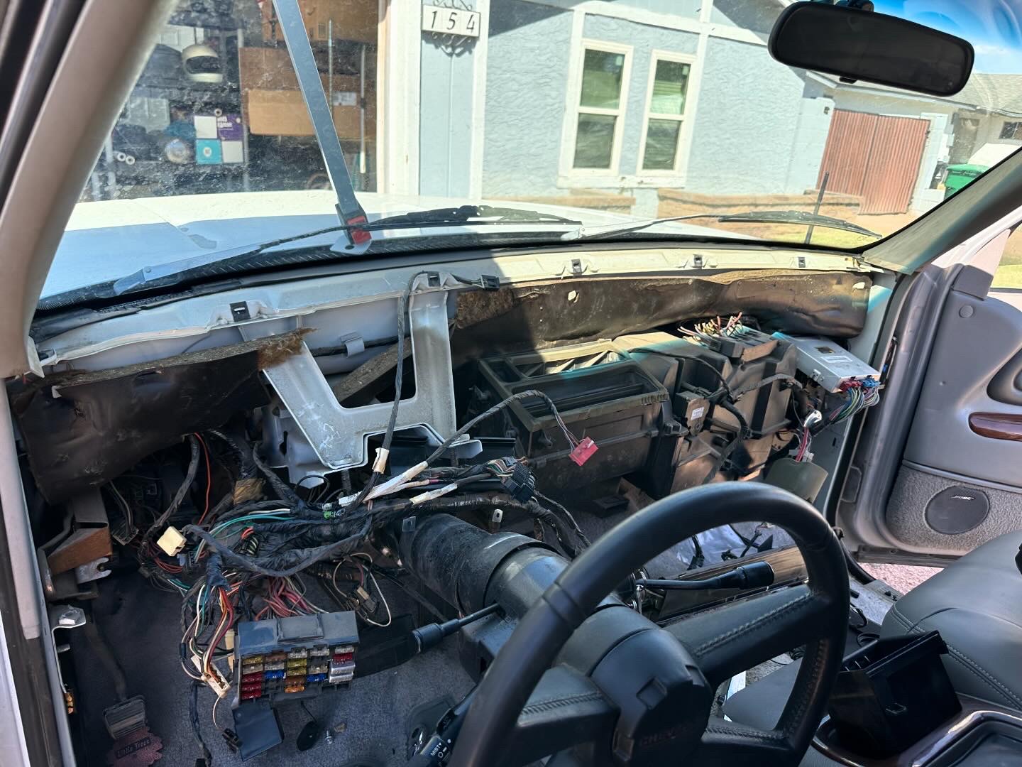

Little update. Picked up a Denali donor for the interior upgrade. Has some engine issues but no worries for me.
Part of me wants to do the whole exterior conversion also but my wife thinks the original front end is “retro” and prefers it over the Denali.
Either way at least I’ll do the interior.

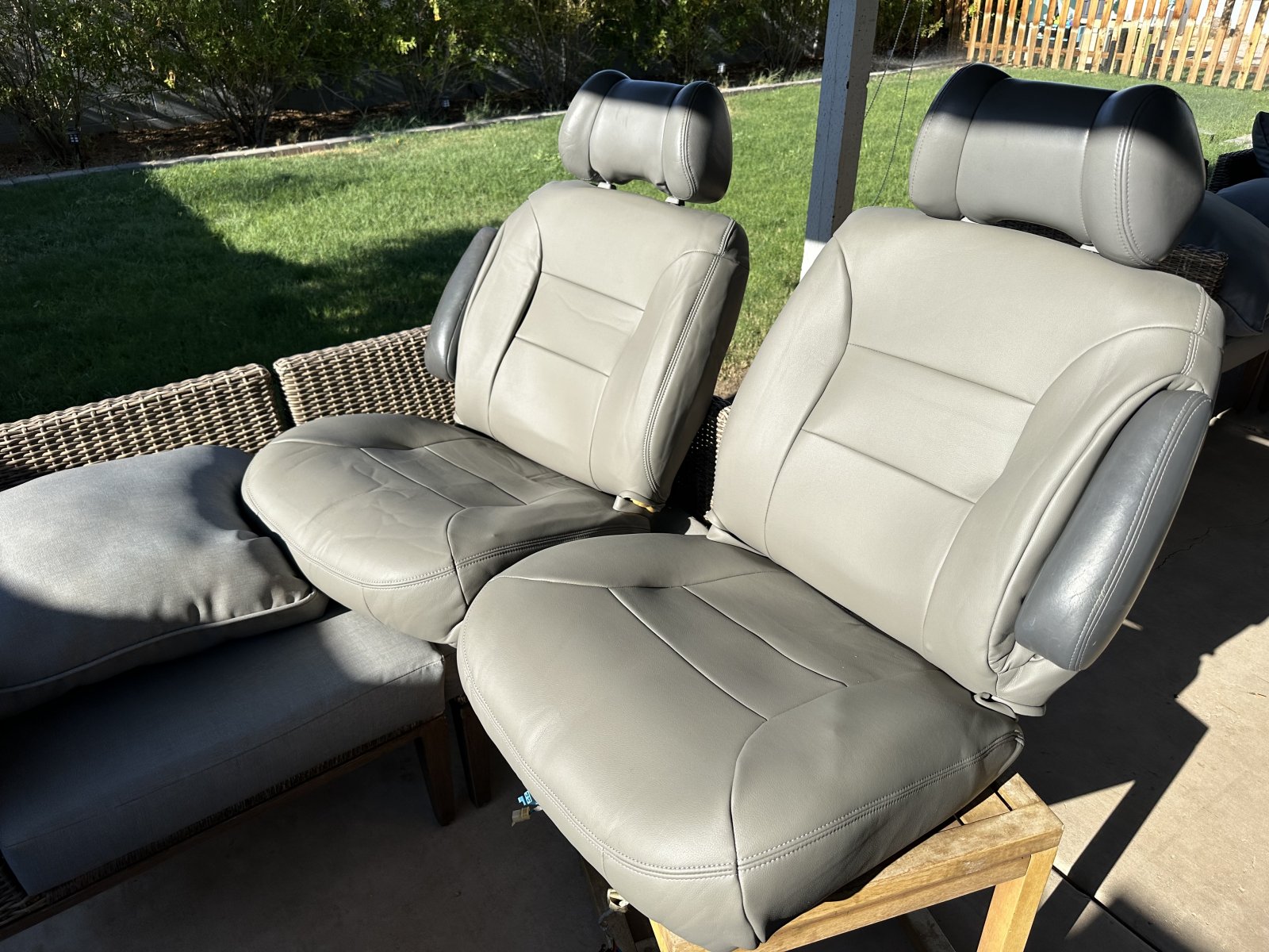

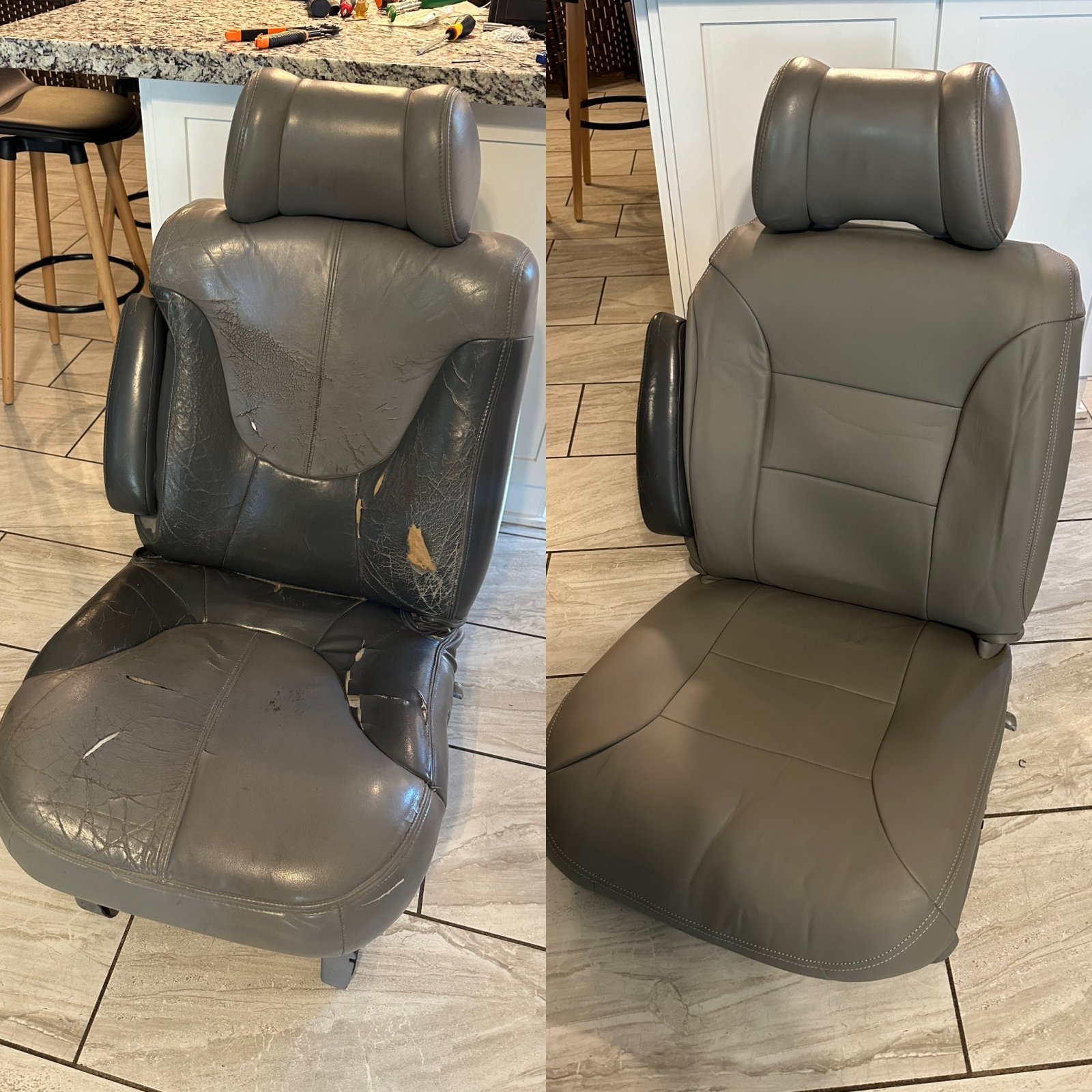

No real update, summers here in AZ is giving it's last go f yourself, so it's been too hot to mess with shit.
I did order some new replacement seat covers for the front seats in the Denali. They were cheap, so we'll see how the quality is when they arrive.
