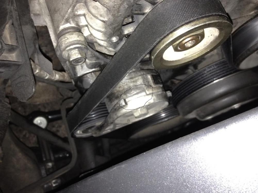

Is that an aftermarket tensioner? I replaced my OEM with a Dorman tensioner, and wound up with a ticking noise while the engine was running. I found that the two metal "end stop tabs" ( I circled them in the pic) were tapping against each other while the engine was running. I put the OEM back in, and the ticking was gone.
Hope this helps.
