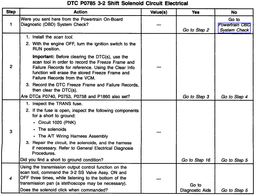

Here are the diagnostic tables for that code on a 98. I’m not sure what, if any, changes were made between 97 and 98, but I would guess that it would apply to a 97. It uses a Kent-Moore jumper harness to test, but maybe something will be of use or give you some things to check. Hope this helps.
