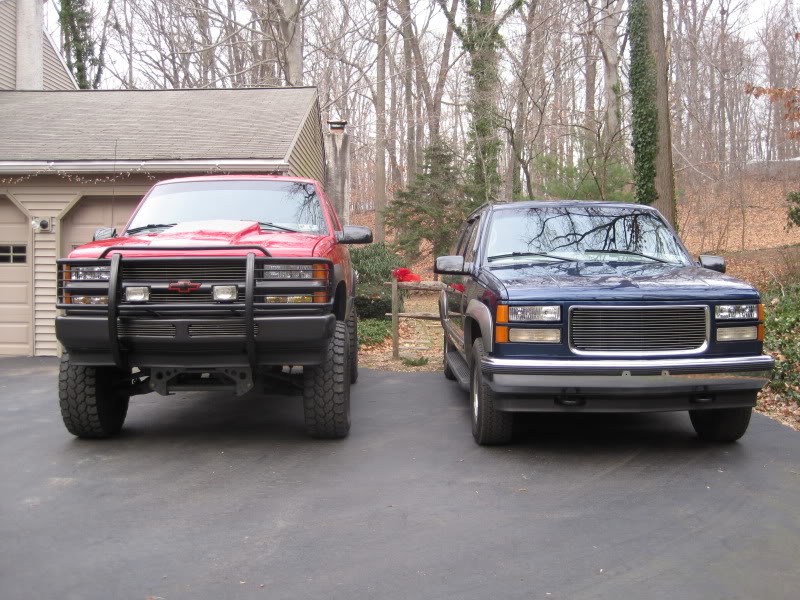

Alright, I'm new here but i was wondering if anyone has any pics of a 99 Yukon with a 99 Tahoe front end assembly. If you dont have pics, but you know of someone who has done it that would be GREAT! i was just wondering if its even possible, and what all i would need to buy and how i would go about doing it, if you know that much!
PS i have no idea why this would help but its a 4 door 4x4 SLT if that affects anything.

By "front end assembly" do you mean front clip?
50,407
17,396
IIRC the only thing you have to change is the grill.
If he's talking about the front clip will he also need different corners lenses too or are those the same between chevy and gmc? I can't remember.

should all be the same, just the parking light cut outs are higher on the yukon grill shell

yeah its the area directly around the lights and grille, not the complete bumper and everyting. so if i go out and buy a 99 tahoe front clip, ill just have to re adjust the parking lights? how hard would that be? sorry this is my first SUV to fix up, thanks for the replies

by clip, you mean hood, fenders, radiator support, grille, etc? all you would need to change is the grille, and POSSIBLY the radiator support, but i'm not certain about that. the hood, fenders, fender liners, bumper, etc., are all the same

I've always been more of a fan of the GMC grill myself only cuz I think it looks cleaner.

yup, other than the ugly chrome ring around that grill. An up close look of those two trucks and the tahoe looks cleaner, just in overall fitment
