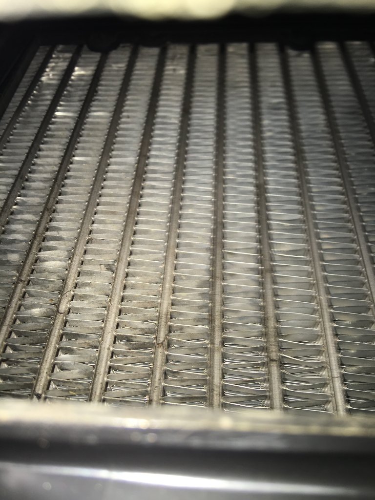

So.... starting to think @kbuskill has the right idea. Thinking its the evaporator coil freezing up causing low velocity of air out of the vents after a couple of hours with the AC on. Hard to replicate since I don't drive very far ver often. So my options are to have the dealer do a BCM scan and pay $110 for the diagnosis, buy a scanner and do it myself or start by hooking it up to a manifold and check out the pressure. Any advice on the next step to take to fix the issue??

Did you change your climate controll lately? Mine would do this on long trips. I needed to have the controller flashed at the dealer.

Mine was exaclty what you mentioned before evaporator would ice up and my passenger side floor would sound like a wind tunnel. It was because i changed my climate controll because my buttons were worn down and didnt have the new one programmed to the truck correctlt.
