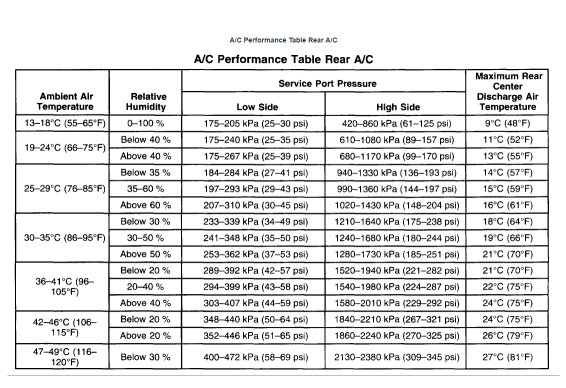

D) Refrigerant pressures (when relay jumped) seem to be within margins for the high ambient temps (50psi/230psi+/-) however the air doesnt blow cold and the high/low lines are both warm/hot.

Curious...why would the pressures be close to accurate if this may be the cause? Thanks!

I believe the key here is the sign of dye. I believe it could be overcharged. Previous owner may have just used a quick tap can from parts store. Take it to a trusted shop. Evacuate and pull a vacuum and make sure is left on vacuum for an hour to get as much moisture as can out of system and then charge to correct amount for front and rear system. Still could have an intermittent blend door problem but need basics first and that is making sure has correct charge amount and maybe even change switches while system is empty.

Thank you for the reply. Still searching for issues. Will be recovering refrigerant myself and pulling vac. I was thinking maybe a mixture of the dye possibly clogging the orifice tube in-turn increasing high side psi causing compressor to disengage. Will be replacing high side switch when it arrives, along with the ambient sensor (just to make sure). I miss the days of simple AC design...
