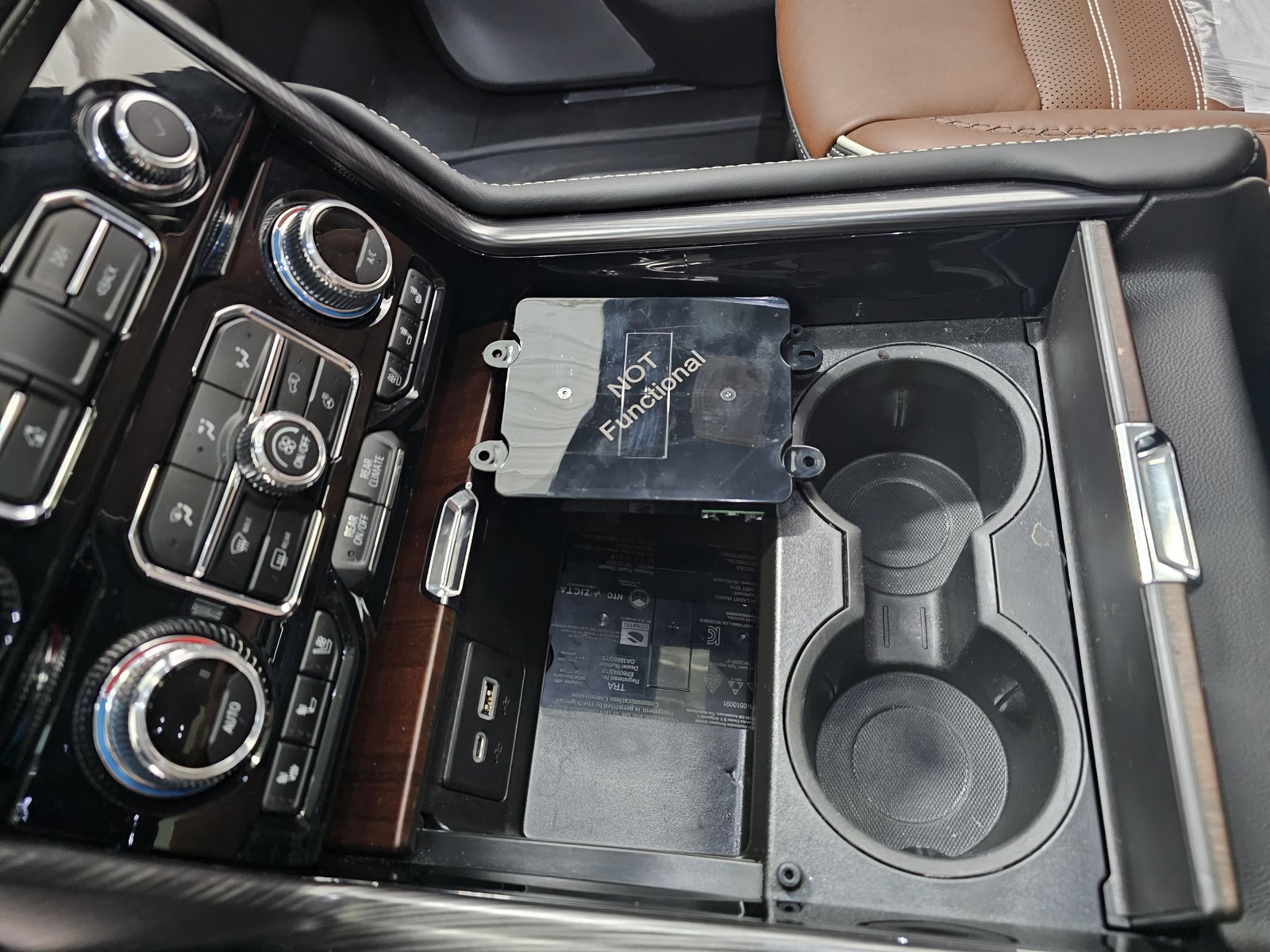

My 2023 Ultimate with sliding console came without the phone charger. If you have one of these and lift the rubber mat console and see a module that says "Not Functional" it is not that hard to install the fix. Maybe about an hours labor. Total cost for the 2 items about $150.

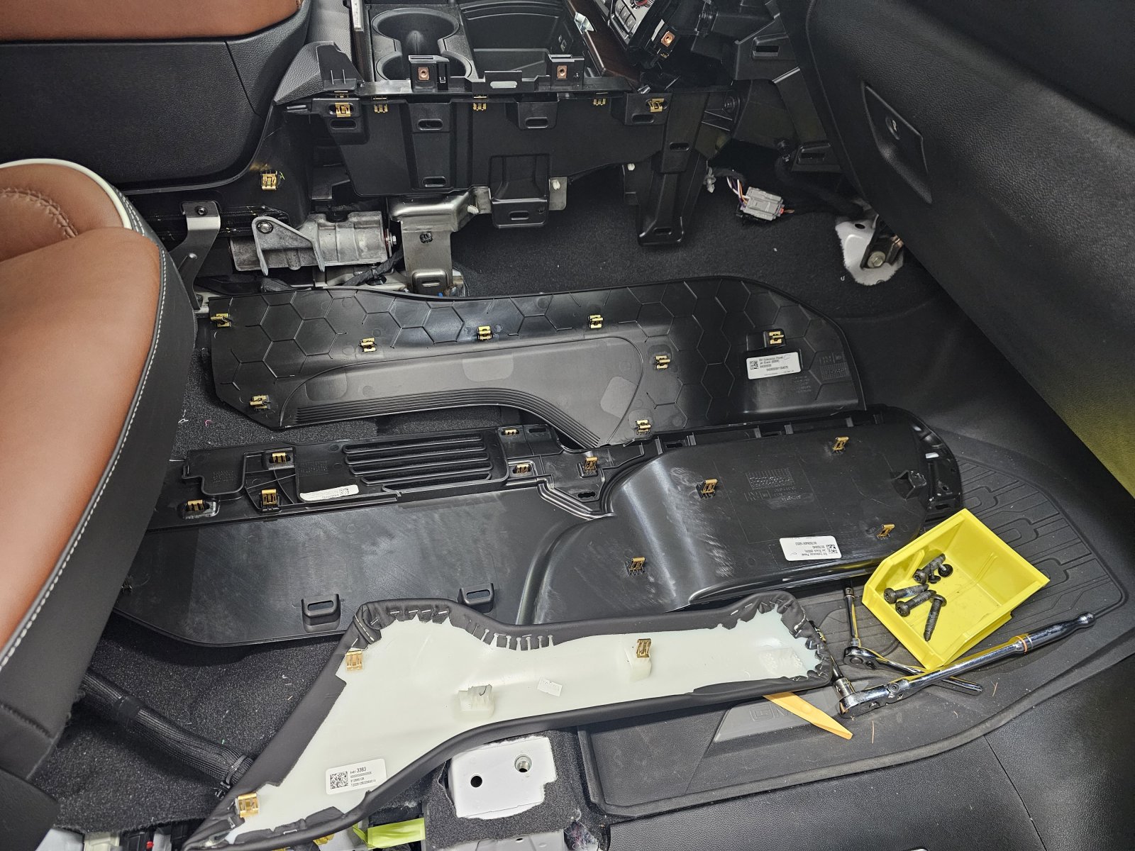

You first need to unbolt the passenger seat and slide backwards. Then remove the trim on that side. 20231216_080129.jpg

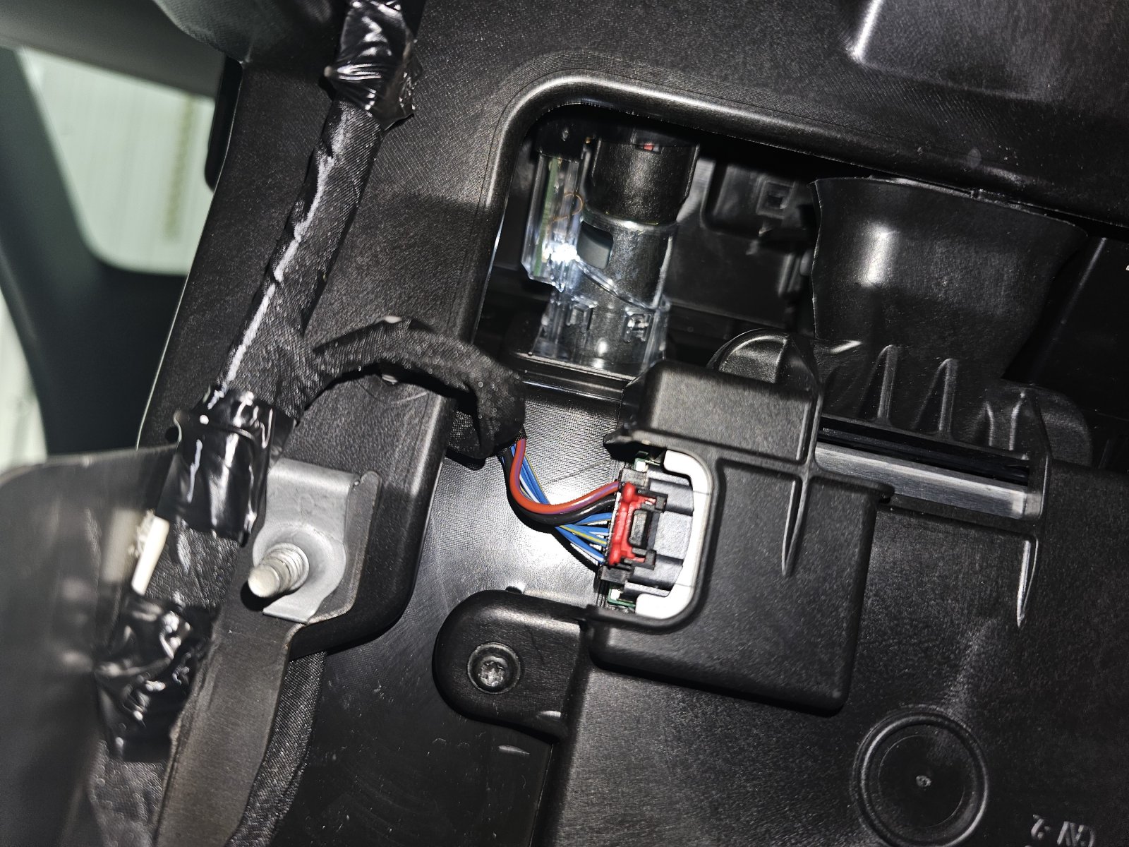

The module can be removed by reaching under the console, unplug the non functional unit and removing 4 screws. This pic is my cellphone looking up.

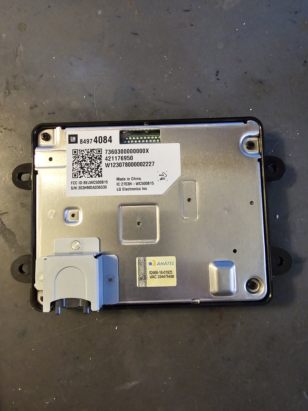

Install module #84974084.
You should also replace the rubber mat on top with the wireless charging warnings but not necessary. Part #84477079.
