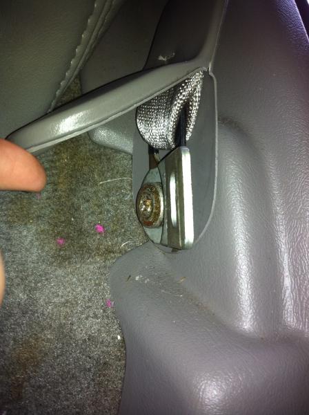

The first thing I did was go to the local boneyard and check out GM products for an ideal belt anchor. I was looking for the belt bracket that connects a belt to a pillar. My thought was to use it to connect the latch system to. I was cautious to look for a bracket that had an appropriate size hole where the belt wraps around. I found a converted Astro van with what I was looking for. Cost, $0. The counter guy let me just have it.

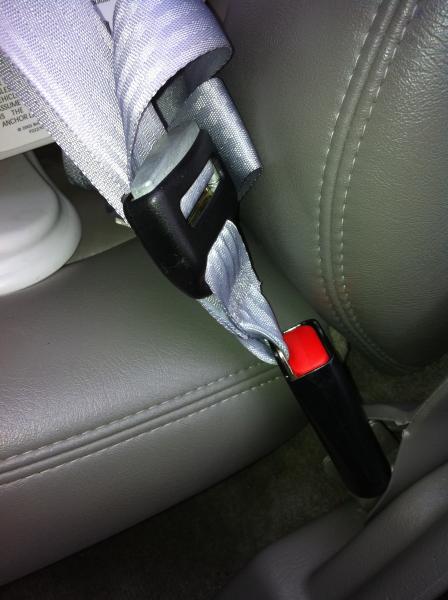

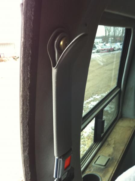

In the three pictures you’ll see the photo of the donor part still in the Astro. Then there’s a pick of the anchor bolt on the driver’s side C-pillar. The next photo is the additional anchor in place. Note that you’ll need the appropriate torx driver to remove the bolts in both your truck and the donor vehicle. The last photo shows the seat latched in place. For the other side of the seat, I used the left latch point for the middle seat. There was plenty of room.
