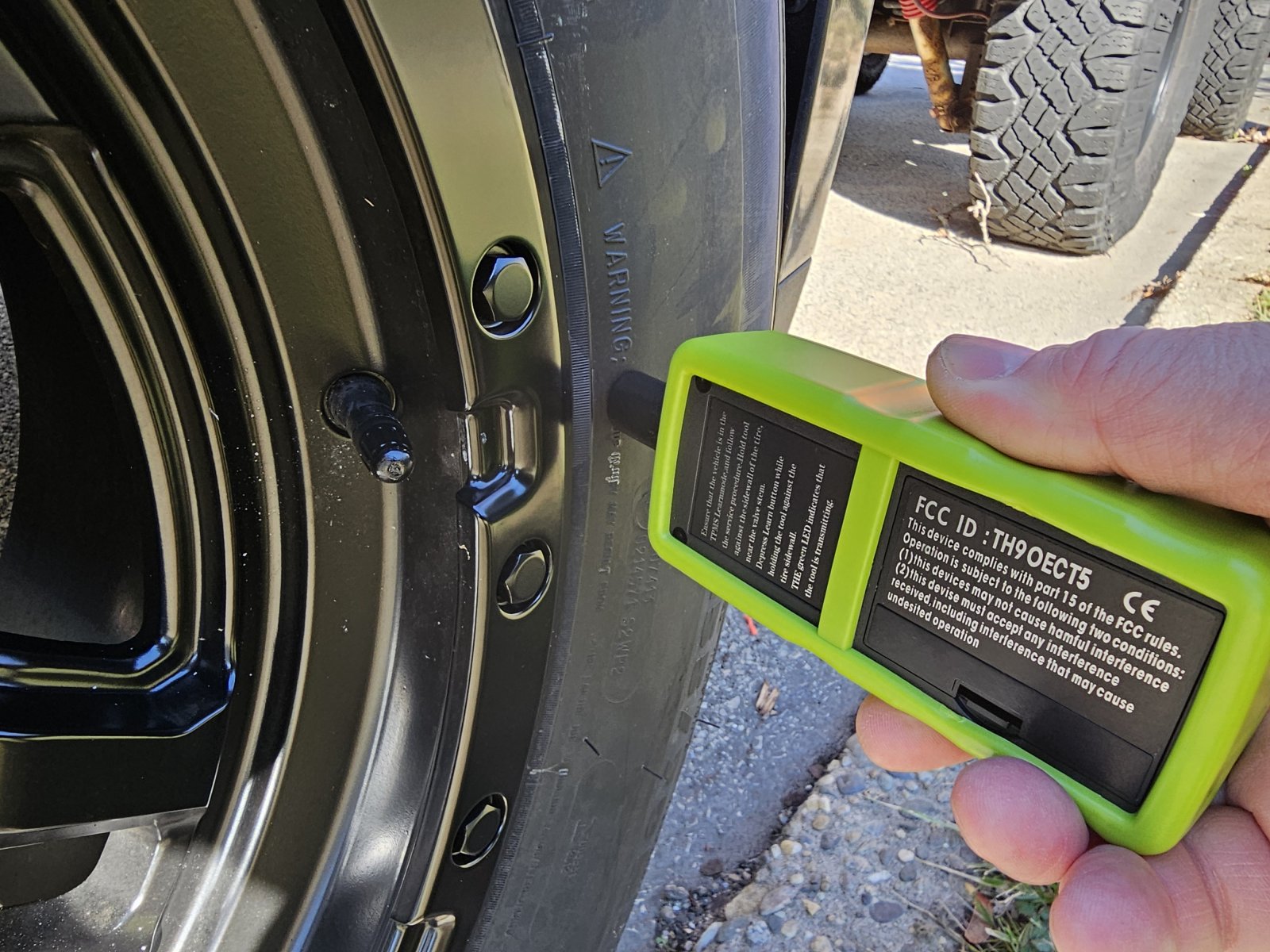

Of the vehicle or of the sensor?How can you tell the current frequency?
Sensor should have it printed on it.
Vehicle by model year. GM used 315mhz up through mid 2019 then switched to 433mhz
Sorry for the late response here is the listingWhat P/N did you buy?
Ok so both my 2021 Tahoe and 2022 Suburban use the 433 frequency?Of the vehicle or of the sensor?
Correct.Ok so both my 2021 Tahoe and 2022 Suburban use the 433 frequency?
Thats not true for the 2022 and newer yukons.You just need to be sure that the frequency that your truck uses for the current TPMS sensors is the same frequency for the new TPMS sensors.
What frequency do these VIP tpms sensors use? What frequencies does the relearn tool you bought use?Thats not true for the 2022 and newer yukons.
I think they are trying to tell you that it is more than just Frequency for the new VIP architecture. Exactly what the "extra" is is unknonwn, but I do know that the Tahoes/Yukons/Suburbans/XL's and Escalades use a different P/N sensor than the trucks.What frequency do these VIP tpms sensors use? What frequencies does the relearn tool you bought use?
433mhz is the frequency.What frequency do these VIP tpms sensors use? What frequencies does the relearn tool you bought use?
Interesting433mhz is the frequency.
