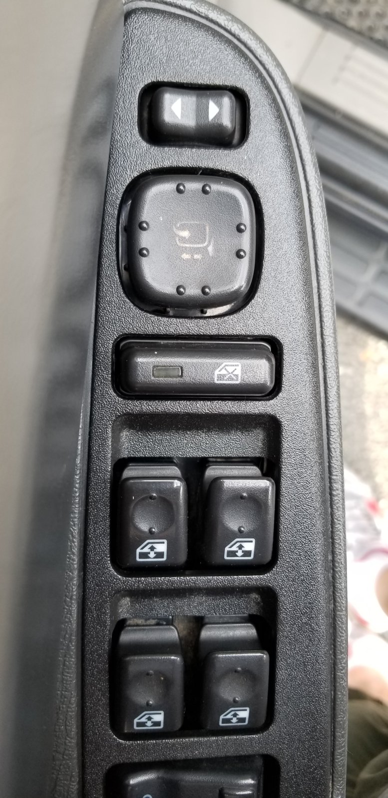

All you need is the pwr mirror fold switch, other then that everything is pnp. Tried it on my 03 Tahoe, it worked.20180608_170206.jpg

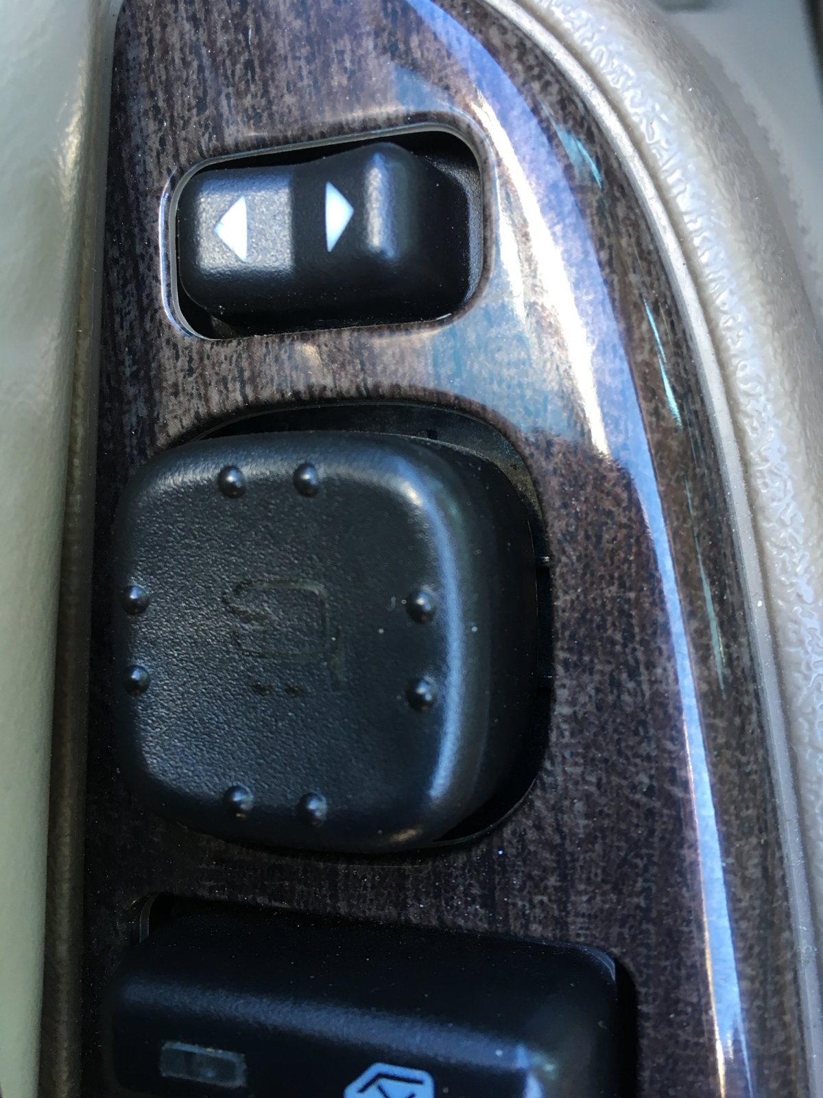

So with that switch, all you would need to do is press it to open and close or hold it down to open and close?
You out the side selector arrow in the middle, and then you hold the right side of the square down for a second and it folds the Morris in. Then you hold the left side of the square down for a second and it’ll fold them back out.
