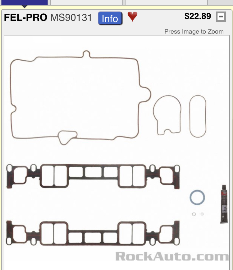

Intake gaskets would be the one thing that I’d look at on the vortec 350. Not a question of if they were done, but when and what gaskets they used. For a 1998, they were probably first done just out of warranty (say 50k miles) and then again within another 50k miles or so if they used the original GM style.
They need to be the ones that have the metal backing. Felpro and others make both the cheap OEM and the better ones.
You’d want these:
Not these:
