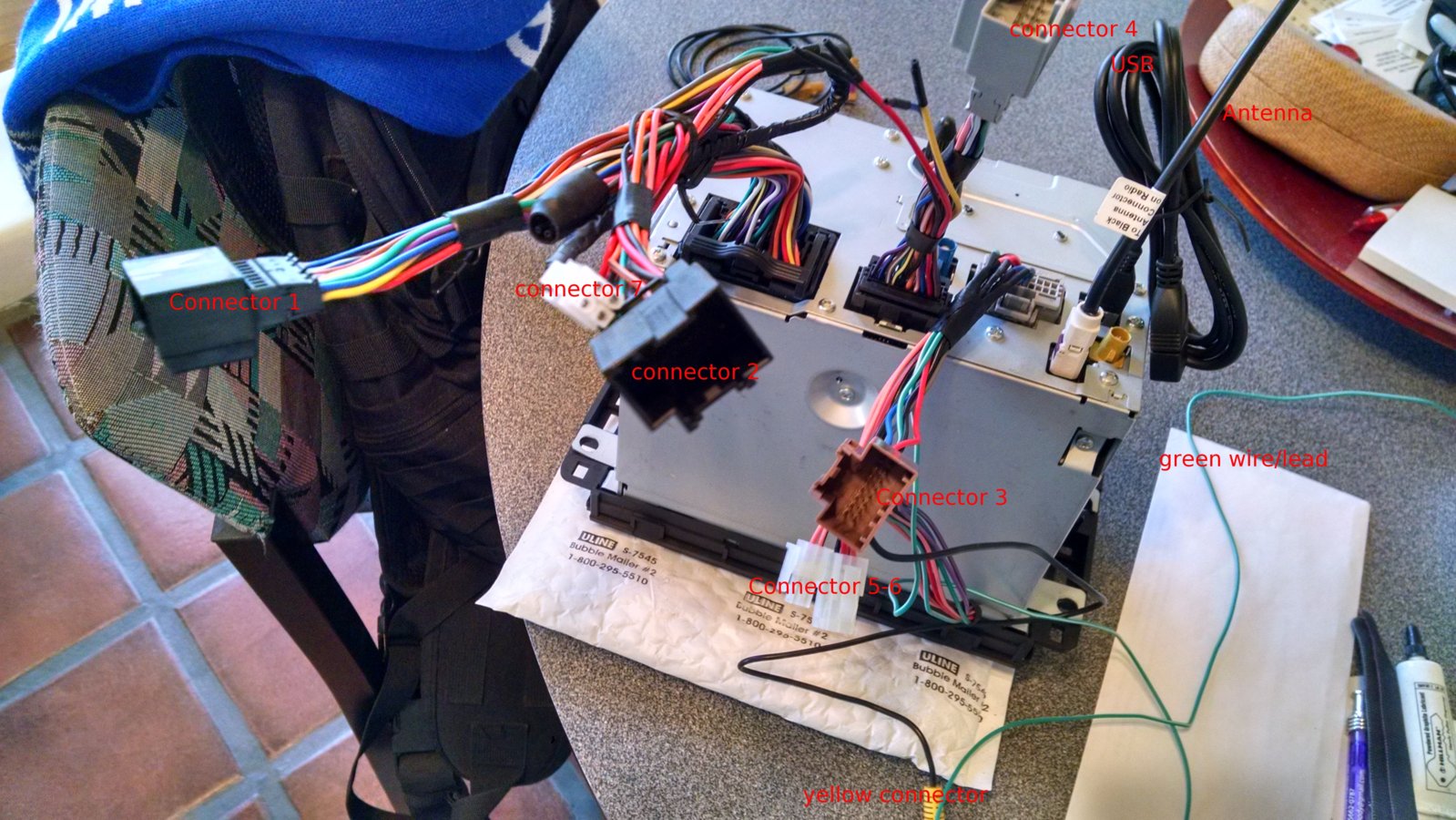

Here are a few pics of what I bought, the GM Nav Radio head unit (the last one has the GM part # on it.) It is know as the "GM Nav HDD Radio": HDD meaning it has a (ssd) hard drive, for storing maps and recording music, GPS way-points etc etc.
Ron

Oh btw: IF (big if) you have a car that is already setup with rear seat passenger audio, then yes it will work (the rear audio). BUT in general our SSVs/PPVs are not set up like that and ours have the different, simpler, instrument cluster harness. I found that, unless I was not that thorough, there is no 'kit' that will connect the rear audio in a SSV and PPV.
However, I did chat with a guy in CO, who said "I am sure we are able to figure it out and make it work, but I am sure it is not worth the $$$ to you.
So... it might be possible, if there is an existing solution, I'd consider it.. BUT .....
Ron
