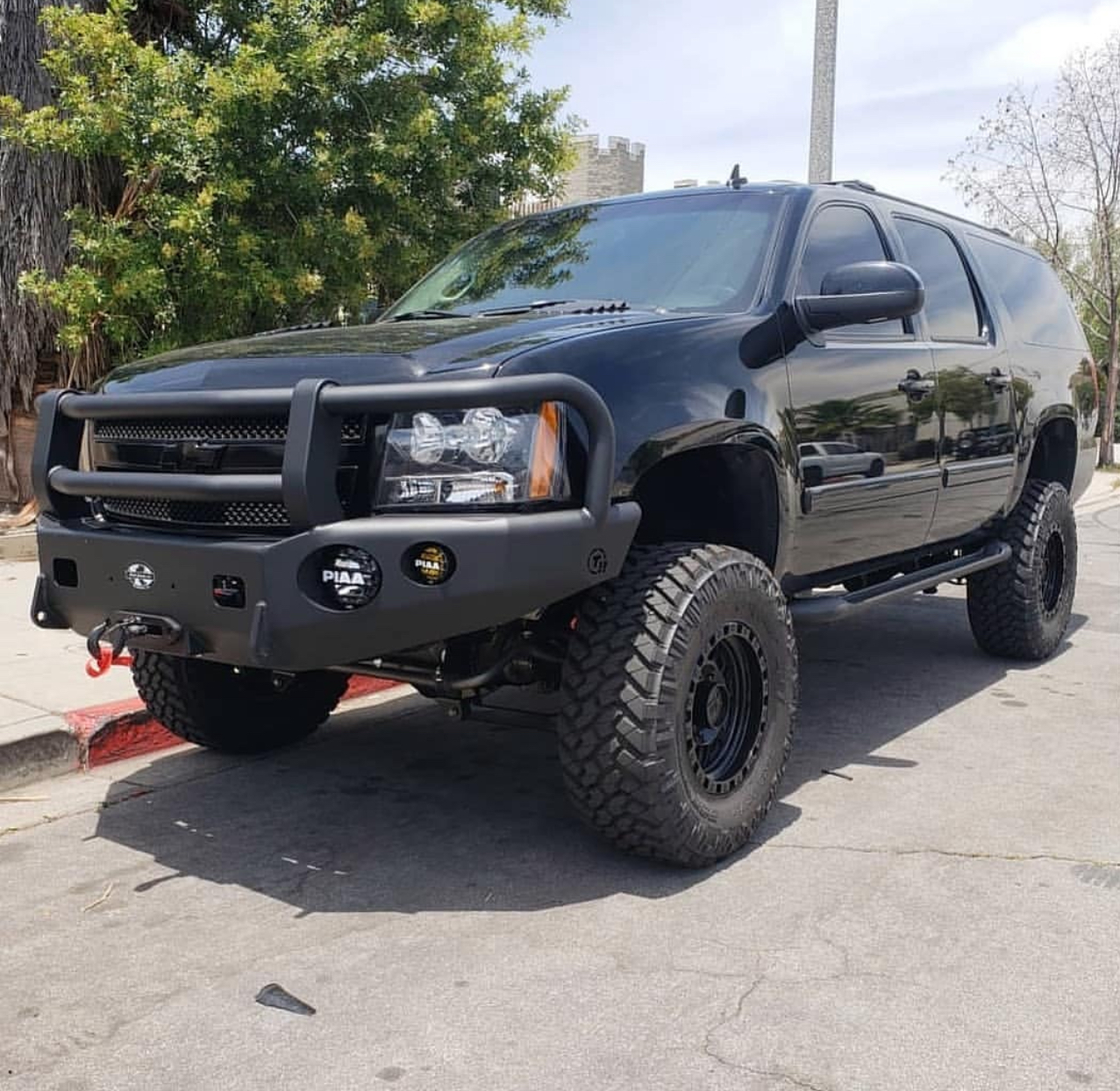

The frame ends are different on the Silverado and Tahoe. I oringally modified a Sierra bumper for mine because there wasn't anything available for the Yukon. That is going to be closer to the Tahoe light/ grill spacing. I had to cut off the frame ends and drill holes and make my own brackets. Since then we have helped bring several bumpers to the maket for the various generations of the Tahoes and Suburbans. Here is a good low profile winch bumper option. I've hit a dear with mine and just broke the headlight and gill. There is also an add on stinger option for them to provide a little more radiator protection.
We also carry a TrailReady Full Guard Winch Bumper if you really want a monster bumper to protect everything. They're about twice the price, weight, and lead time.
