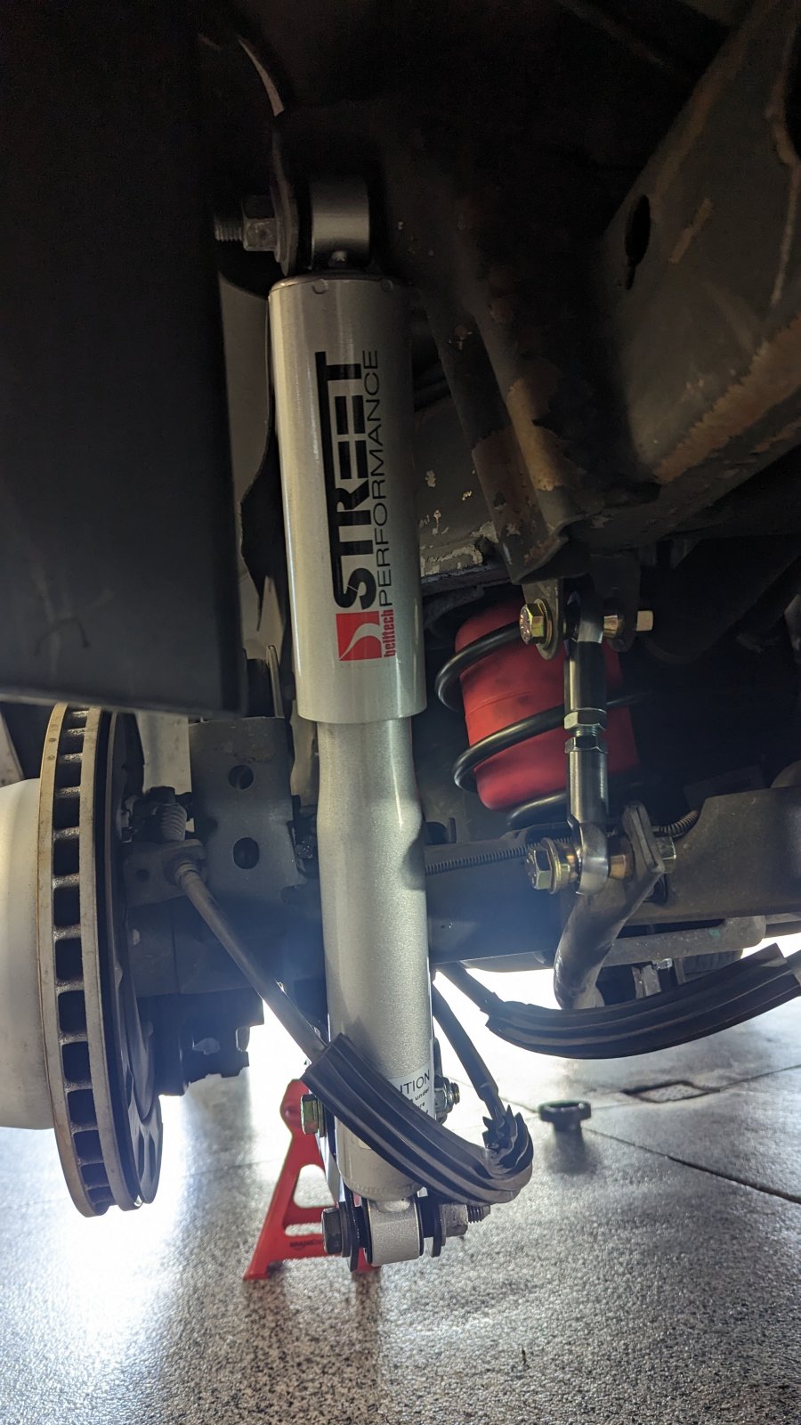

Trust me on this get rid of it. I've done thousands
I set up rear Bilstein or bellte h hd shocks and if you tow helper bags and rides/tows better than oem
Thanks for the info, brother. I've been really debating what to do with it. I tow a heavy trailer once a week for a short distance. The rest of the week it's my family car and hauls all the kids around. Really torn about deleting the OEM system and going with something simliar to what you described. Do you have links to the parts that I'd need to pull this off?
