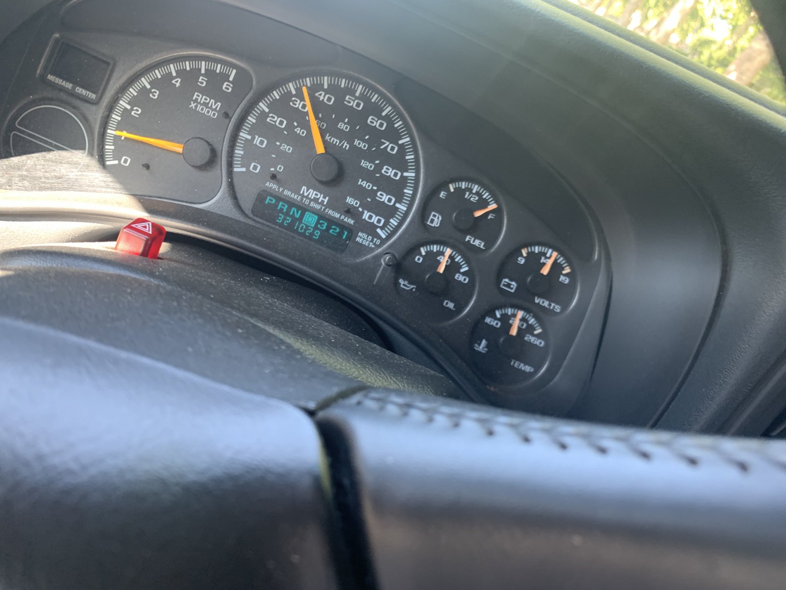

And also sadly there's no cap to peek down into to see them. As of right now it's installed I taped off the oil cooler side for now but it's sitting steady at 230-235 degrees. I know my thermostat has been sticking but damn. Unless it could be something else like an air pocket etc. Everything fit good like REALLY good all the hoses felt like factory fitment. 20210708_232353.jpg

With core thickness being 1.26 inches, 1 1/4", then it cannot be more than a two core radiator or a very wide single core. As long as it cools, who cares. Do you have an infrared temp gun to check actual temp at the thermostat? If you knew the thermostat was sticking, why did you not change it to have a new thermo and a new radiator. C'mon man!

HAHAHA because i still need to go get one. Am lazy sometimes but no harm no foul all it needed was a little burping. And so far I'm 3 jugs of 5050 in and she's still thirsty. I'll get more after work. Once everything is dialed in proper I will give cooling differences. I'm sure adding that oil cooler will make a difference as well.

My 2001 Tahoe always sits at about 190 at all times. It did go to 210 when it was 108degrees one day. And I was idling for 30 minutes. I think it may still have air
