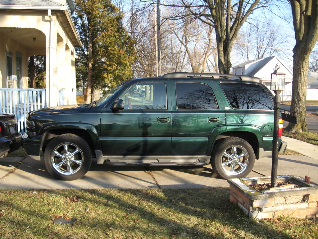

try and get an actual weight rating out of american racing before you pull the trigger on those rims. I had 5 lug 18's on the tahoe limited and found out later on that the weight rating on the rim was only 1500 lbs each, on a truck that tipped the scales at 5850 lbs with the big block, 4l80, big rear and stereo system. That was before I put the 24 ft enclosed on the back. Not sure if you plan on using your truck for truck stuff.......but it might be a consideration.
if you read the description they're low pressure cast. The forged weld's on the suburban are something like 3800 lbs a rim. (ironically weld and american racing are part of the same parent company)
Yes I'm towing a boat thats 6300lbs with fuel & trailer. I have no idea how much weight all the other equipment adds to it.
DP121
DP121
Feb 11, 2016
22
According to American Racing's web site it appears that the load rating for these wheels is 2200.
