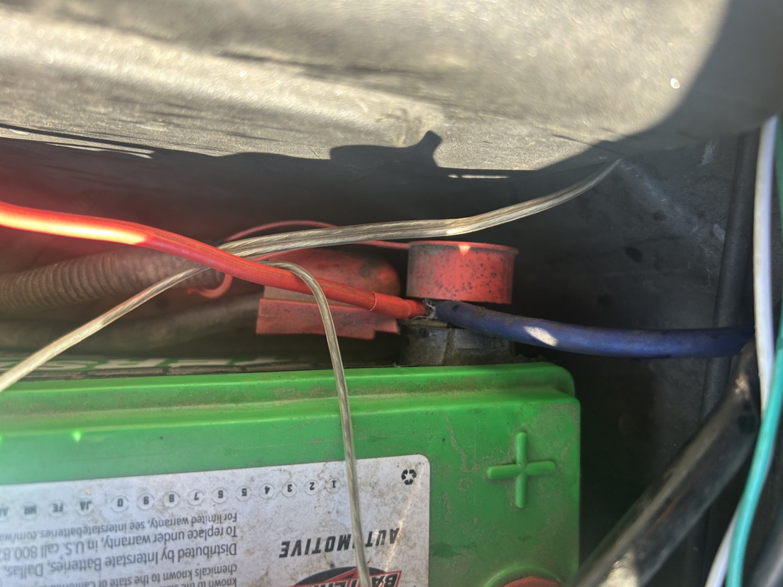

ill take another look at the harness then heres some pics to see what wiring an stuff i have going on its a work trucck so excuse the bottles an junk an tools XDthumbnail_image0 (1).jpgthumbnail_image2.jpgthumbnail_image3.jpgthumbnail_image6.jpgthumbnail_image1.jpg

That wiring is an absolute nightmare. You need to test each item. You need to rewire that harness for the factory amp. You need to purchase an amp bypass harness. You need to run proper gauge wire to that amp, connect and terminate it properly. Your ground wire is smaller than your power wire. Your connections at the battery are atrocious. I don't know what that silver wire in the picture with the fuse holder goes to but there's no fuse on it. Basically, after you verify that everything works, you need to start over from scratch

lol, my wiring looked similar when I was like 18 and had never done anything like that before, love the magic tape
but I quickly learned that most of that mess doesn't work out
what is mostly screwing him is the $10 adapter harness
