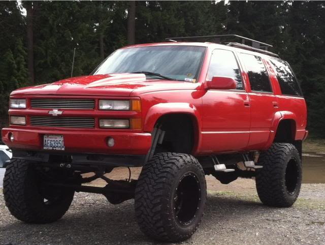

So big body, before I order the 37s. It looks like your homeboy has a body lift as well. If so thats going to be a lil to big for me I think...

i dont see how you would run anything smaller as far as lift for 37's.. thats alot of tire and width to try and shove in there.. your backspacing has alot to do with it.. i would stick with 33's on a 22" rim.. 35's are really not going to make a whole lot of difference and you can keep your stock gearing.. either way its going to be form over function.. theres a few 2drs ive seen rocking a 6" lift with 22's wrapped in 33's and they dont look to terrible

33's on 22's would look like street tires... You can fit 35's with just the 6" and they look pretty good. Yeah the clearance depends on your back spacing but just crank up the T-bars .5"-1" higher than the back and you'll be more than fine with any back spacing. I prefer that slight lean on the Hoes anyway.
