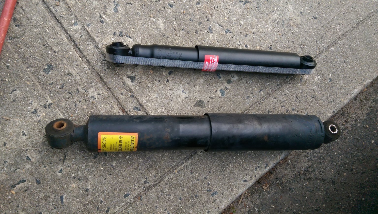

OK, after swapping out the stock zw7 shocks with the kyb's it rides like crap. Bought new bump stops but haven't put them in yet. When hitting a small dip or pot hole the rear feels like it's going side to side a little. A forum member said I'd probably have to swap out the rear springs, which I think I'm going to have to do. But, I plan on lowering it, nothing crazy, maybe 2-3 drop. I don't want to buy rear springs twice, so what rear springs do you guys recommend since I do plan on lowering it? It looks to have settled a little in the rear.
If you had the Nivomat shocks, then yes you WILL need to get new springs. The Nivomat shocks are self leveling shocks, but completely self contained and not connected to air hoses or anything. They are easily identified by their size, they are HUGE. They are about twice as thick as normal shocks.
