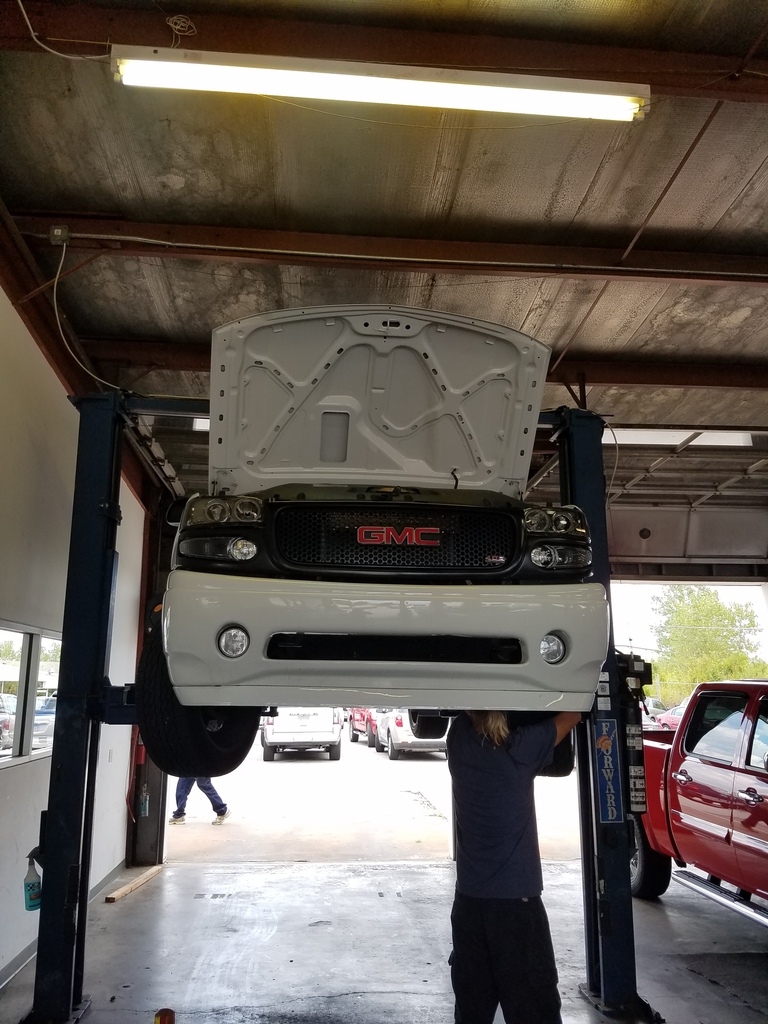

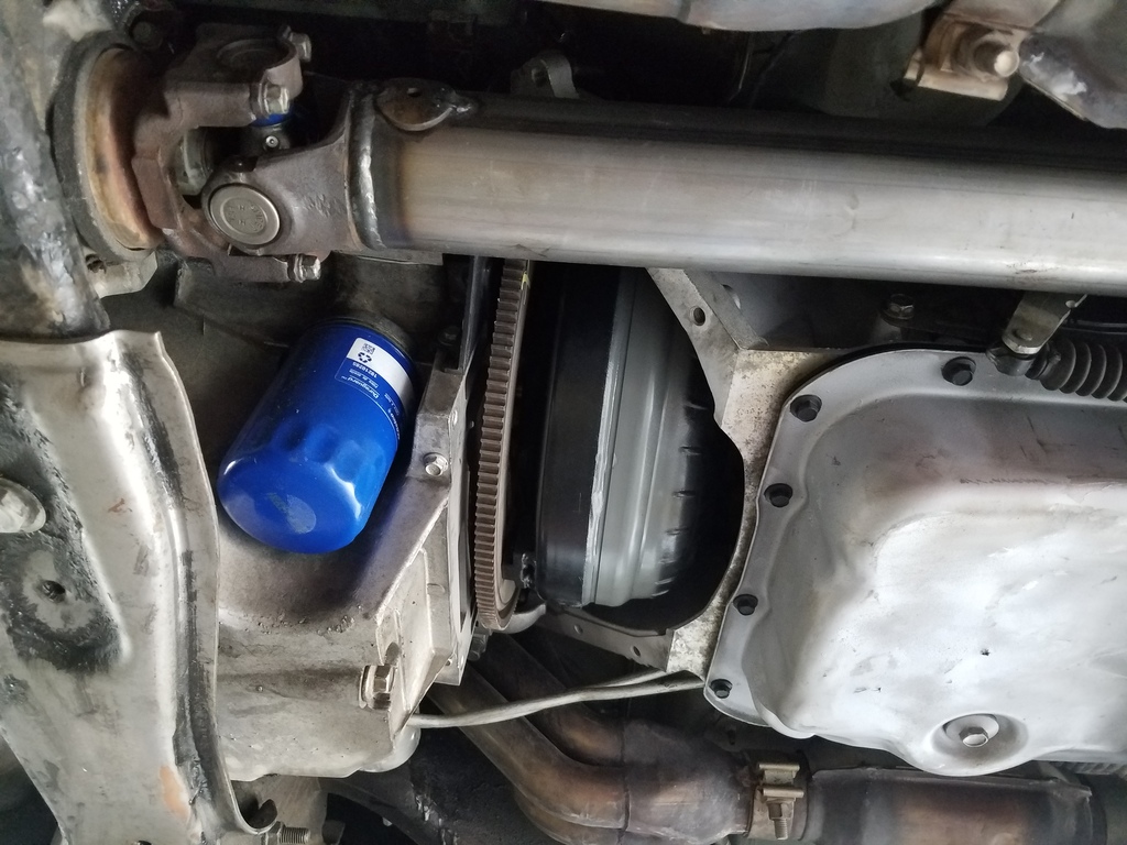

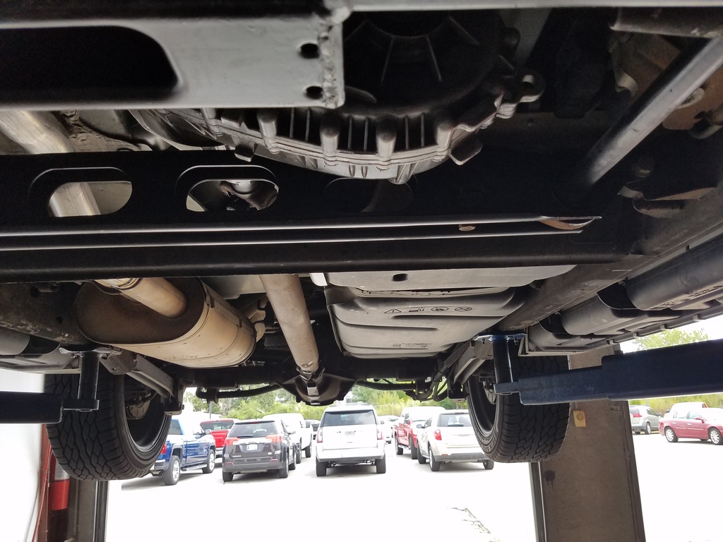

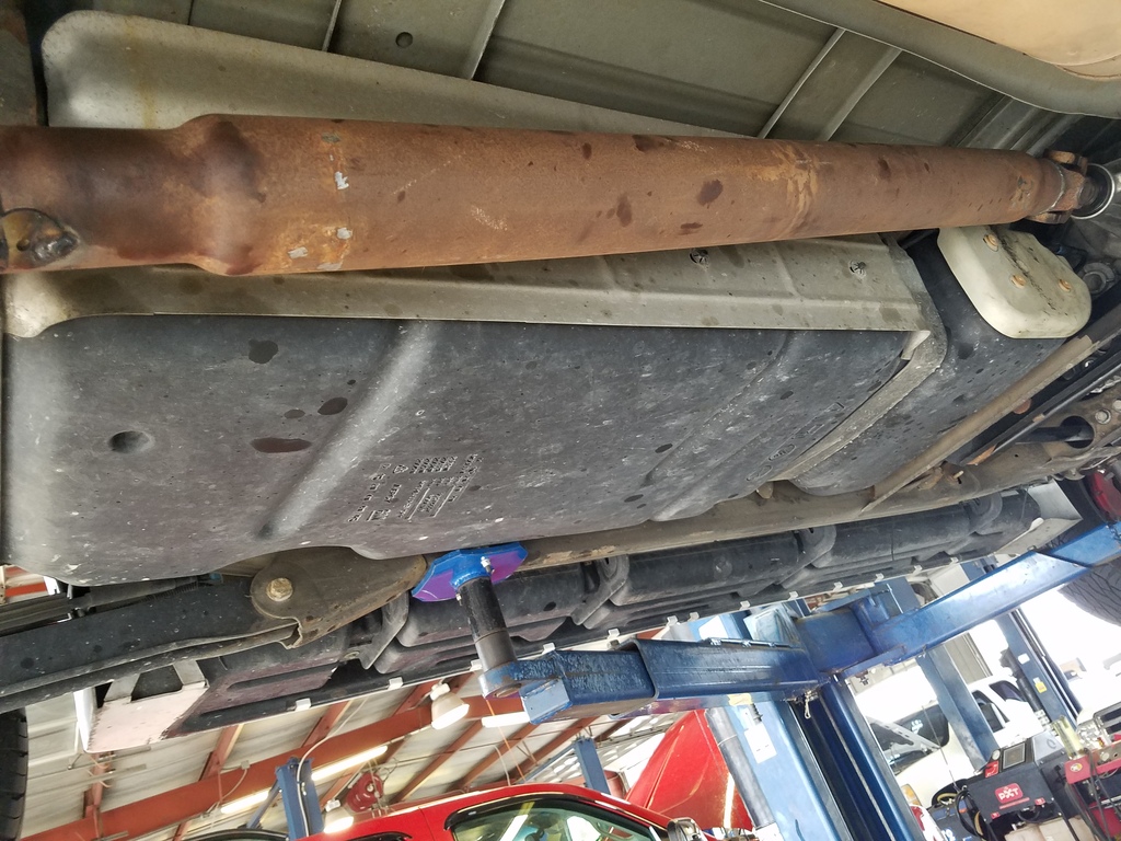

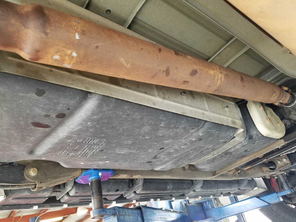

Ok so while the 4L80e was being installed I snapped some pictures of the 26 gallon tank in my 2005 Yukon Denali XL. Have no idea how long or wide the 37 gallon tank is but it would be a pretty tight fit. Take a look

Not alot of room underneath...I am hoping the 36 gallon tank is a bit taller (thicker) then the 26...
