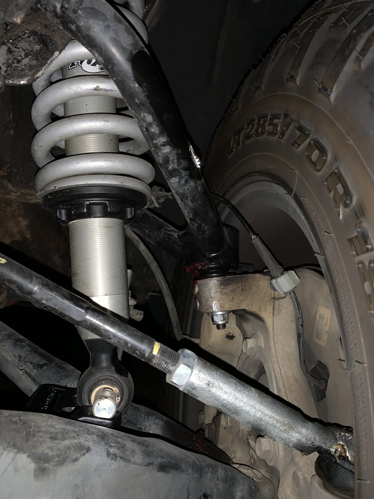

Photos of the UCA's on day of installation:

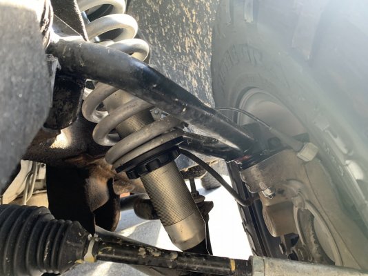

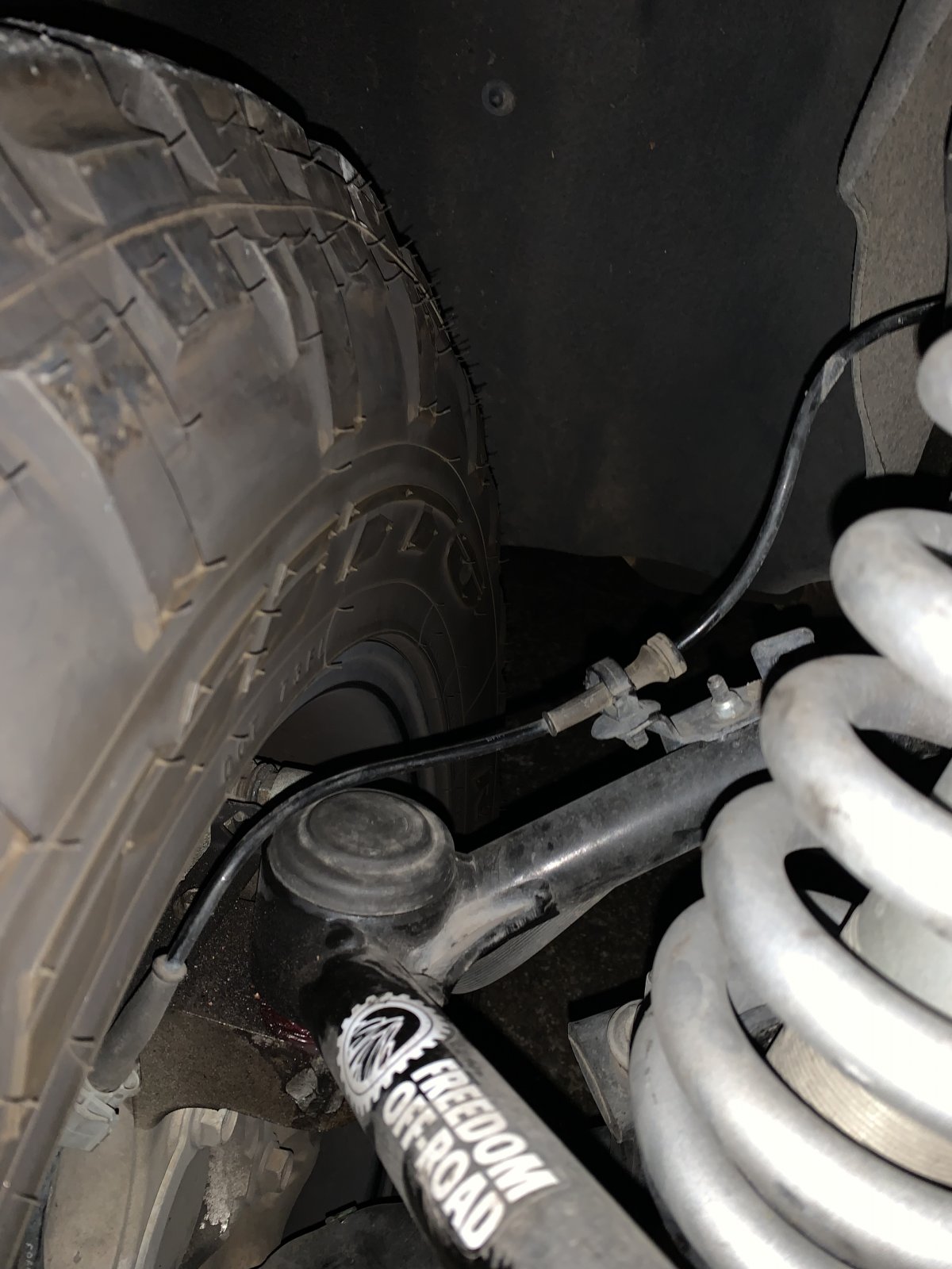

Photo of the UCA's highlighting the minor rub that has occurred:
(RUBBING IS THE GREYED/STREAKY ON THE BLACK TUBING)
