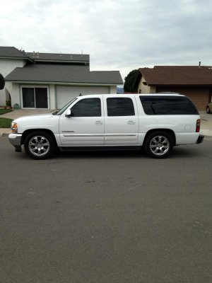

Well shorting the rods so the end links are at 2 and 3/4 on center worked, (thanks Tony). It now sets at ~34" vs 35", no air it was 33 and 1/2. The front sets at ~33 and 1/2. It's going to need the free travel mod, not much space between the shorter bump stops and the axle. Here are a few pics:
