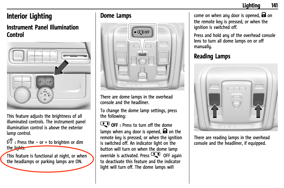

Set the brightness for what you want it with the headlights lights ON. It will move to that whenever the Light Sensor detects ambient light lower than the threshold.
Net, 2 settings, one for Day, one for Night -- I find this most annoying right at dawn or dusk, seems to be dim before it needs to be/not brighten up soon enough for my taste...but, there has to be a threshold.

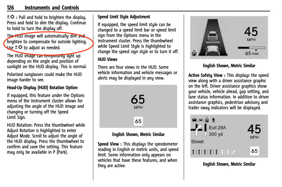

The HUD Brightness is a separate control, but auto dims w/ ambient light.
Relevant Excerpts from the Owner's Manual:

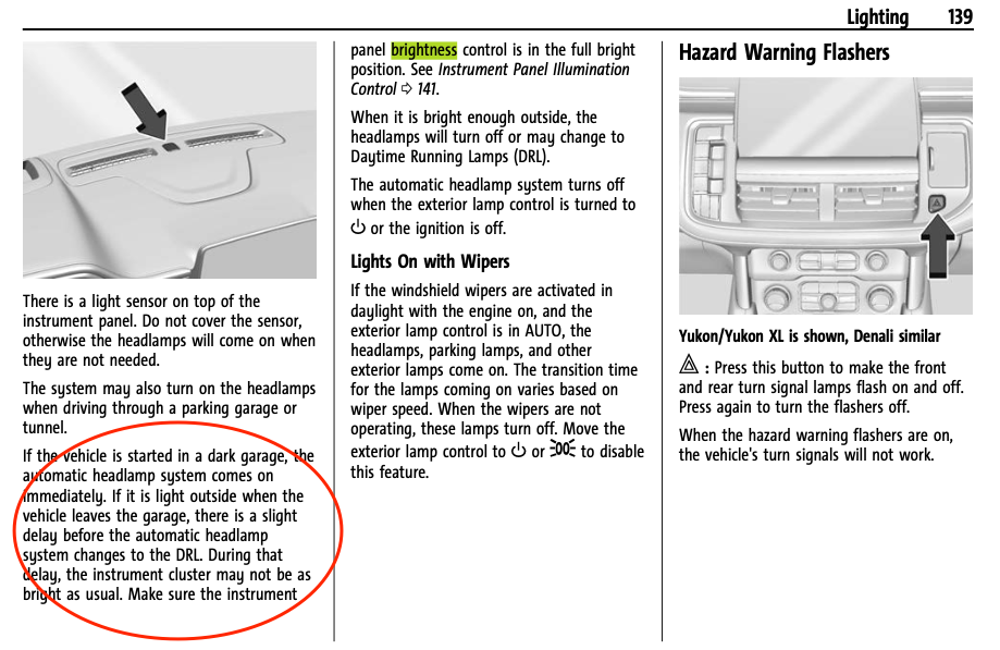

I tried this but it did not brighten during daytime. Maybe I’m doing the process wrong?
