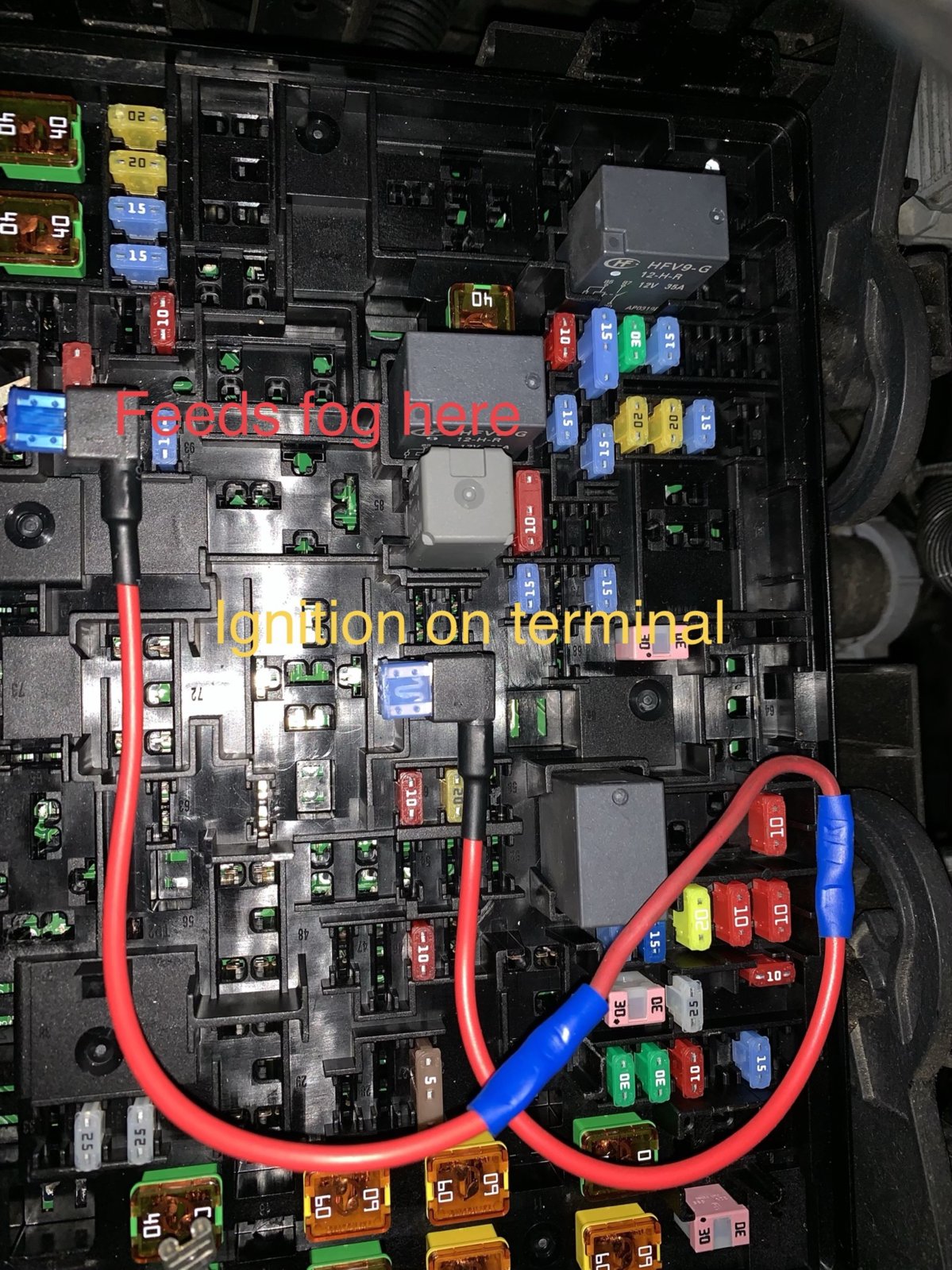

Yeah. Trick is that I don’t think you can activate if the fogs/driving lights are on
True, unless you have your fog circuit modded. I have a jumper feeding the fog circuit from another source which is hot while the ignition is on. Don’t mind since dogs are LED. Headlights still auto dim as well.
Rumblur
Jul 24, 2018
24
Yes, please tell us how you jumped the fog lights to be "on" anytime you want them on.
RST Dana
Jan 15, 2018
1,581
1,364
OH
How did you do this?

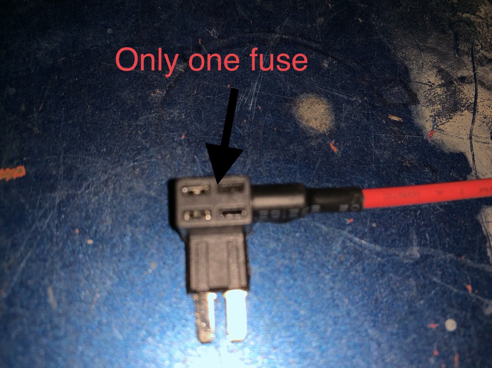

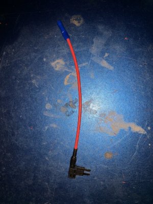

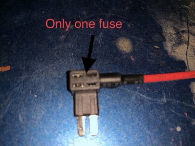

Found a terminal under the hood that has 12 volts with ignition on. Joined two of these devices together with ONE fuse in each end. Insert the SAME way as mine and your fogs will always be in while the engine is running. Auto dim still works.
340B4809-5B54-4D8E-8BE6-BB8508B74BCB.jpeg D8D51342-CFC6-4FA7-A09C-CB79DD8C60E1.jpeg 313A2173-6E07-4629-B999-DF2E27A77E34.jpeg
