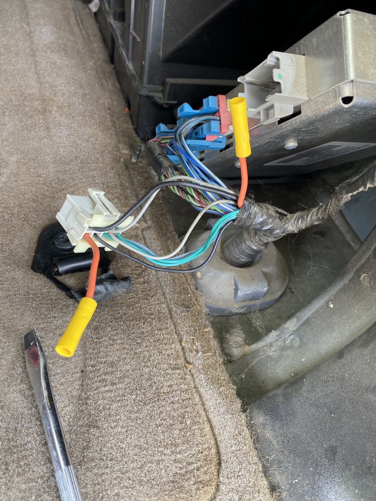

Remove the PASS rear cover in the cargo area. You will see the Control module there mounted to the floor of the cab. There is a large ORANGE Wire that is the 12+ feed. Disconnect the battery and then snip the wire(I put some connectors on the ends of the wire to protect it for futrue use when I install a Viair Compressor for onboard air). Reconnect the battery and let it ride. I have had zero issues doing it this way. I deleted all the autoride shocks in favor of Bilstein 5100s with Z71 rear springs. This winter I am planning on in stall the AFP Coilover setup in the front.
