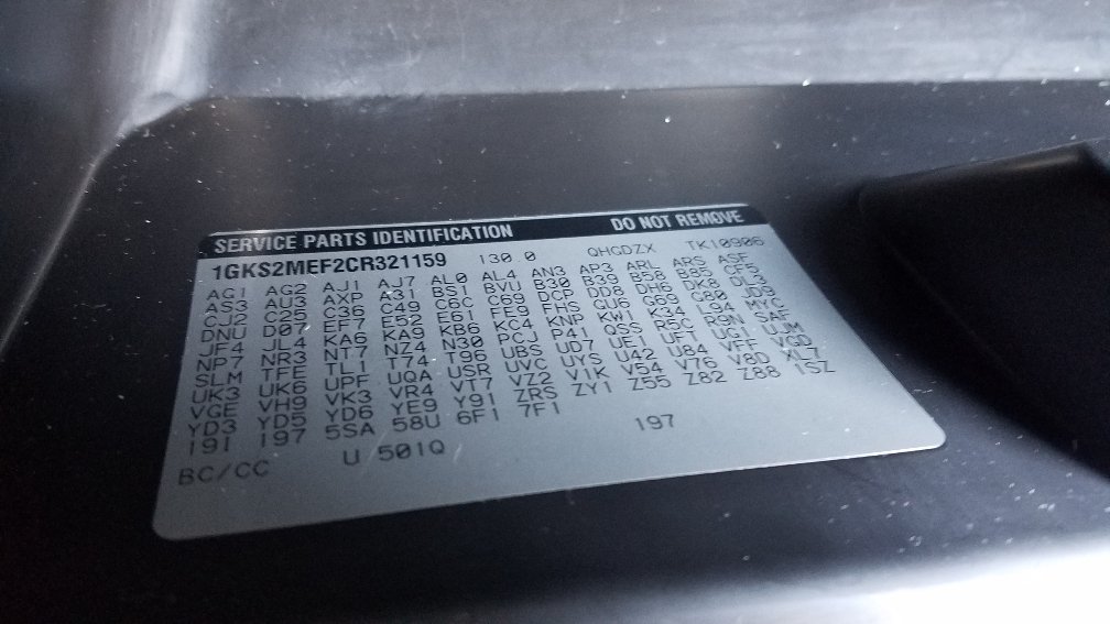

Can you still read the part # on the stickers?
I know I've seen the OE ones cross referenced by the spring RPO codes, which are usually the last 2 RPO codes on your glovebox sticker and start with a 6 and a 7.
On my RPO sticker, the front spring codes are the 6F1 and 7F1
Sent from my SM-G930V using Tapatalk
I have 6XA and 7XA. I have 22's and Z55 in a 2012....
