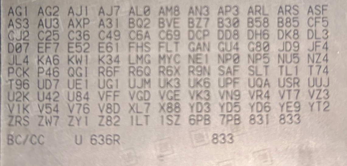

Hello! I'm new to the forum and I just purchased a 2013 Tahoe 4x4. It has the 6L80 6-speed tranny and the GU4 3.08 axle ratio.
I would like to replace the current 275/55/20s (31.9" diameter) with 275/60/20s (33.0" diameter), but all the online axle ratio-to-tire size charts show the current (OE) tire diameter to be too large for the 3.08 axle ratio, already. It seems that the majority of these charts are 20+ years old and were formulated with 3 and 4 speed transmissions in mind and thus, would be very inaccurate for determining ideal axle ratio-to-tire size relationships for 6 speed transmissions.
I am fine with changing gears in the front and rear axles if needed to put me in the ideal torque range. Does anyone have updated axle ratio-to-tire size charts specifically for 6-speed transmissions, or a way to [accurately] figure it out?
