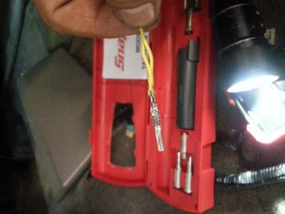

So I'm pretty sure this isn't the only fix, but it's what fixed this tahoe. Of course after visually inspecting all the wiring and connectors under the drivers seat, I had to pull out the trusty DMM. Found out the green wire from the Seat Position Sensor connector to the other end of the harness was OK, (I was checking continuity by the way...) but the yellow wire wasn't. The wire looked fine but it actually broke inside the insulation. So i pulled the wire out of the connector, soldered it back together, put it back on the connector and tried it and... voila! no more light. Well all that was after I replaced the SPS first without checking anything just because the I'm stupid and usually with a sensor "circuit" code... it's usually the sensor gone bad. So anyway of course I didn't just pull out the harness from under the drivers seat like that... I took the seat out, pulled out the harness, untaped it and then checked with the DMM. Anyway, here are some pictures of the job for y'all to enjoy :)

20140813_103508.jpg took the terminal out of the connector. The other yellow wire you see is from the same circuit. It goes to the buckle switch if I remember right. They both meet at this terminal but only one broke... ain't that a biznatch...
