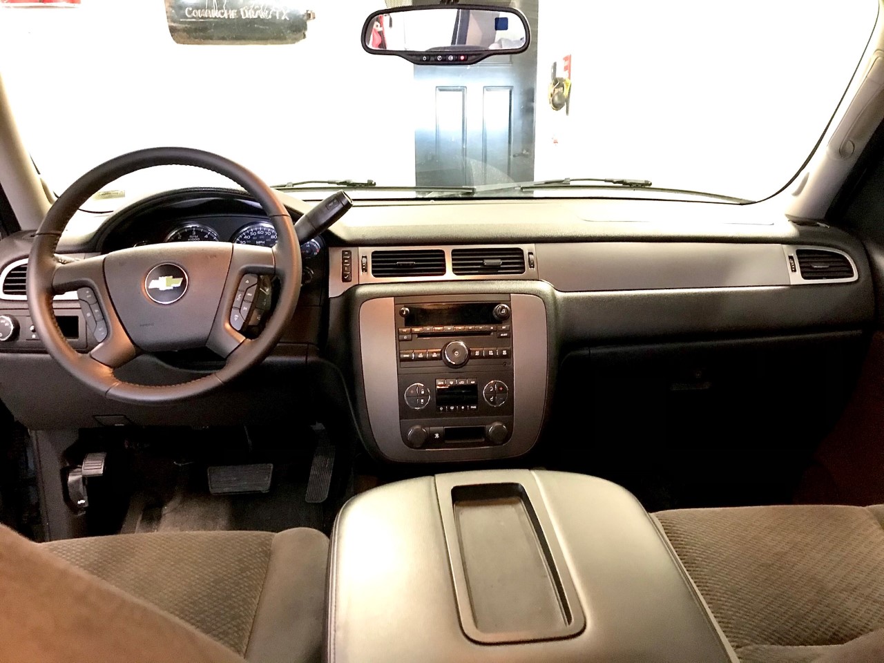

The interior is done. With the deep clean, seat repairs, new steering wheel, console cover, etc. it is a real transformation. I wrapped the wood grain pieces on the dash and they came out nice. I also wrapped the door switch panels but they weren't perfect so I painted them satin black. I used decals on a few of the radio and hvac control buttons. It pained me to do that because I usually just replace them but I keep having to remind myself it's a kid's car for now and I can make it perfect later. I also found a new key fob and key from a suburban we had and programmed it.
My bigger plans are to get the Tahoe back from kid duty in a few months (we actually have a truck for him). by then the exterior clean-up should be done. Then I'll be lowering it, upgrade sway bars, brake upgrades and possibly stereo. And just maybe depending on how all that goes...drivetrain upgrades and turbo kit : )
View attachment 270853 View attachment 270854 View attachment 270855
That painted switch piece looks good. I did the same with a dash trim piece I bought to get the DIC. It was woodgrain.
Nice work. I have wrapped all those parts and know what a PIA they are.
