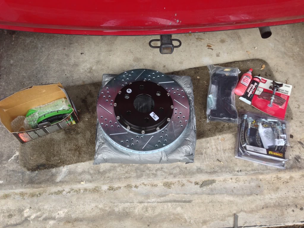

had a semi-close encounter with a mazda tribute that spun out in front of me this morning at 70 mph and decided to go ahead and install the front kit today after class. Rear eradispeed +1 kit is on order.
Truck is a 2000 NBS Tahoe 2wd with a 6" RCD lift kit on 20x12 moto metal 962's and 305 55 20 trail grapplers.
Parts include:
Baer Eradispeed +2 Two Piece Rotor Kit for Front (P/N 2301028)
EBC Green Stuff 7000 Series Brake Pads for Front (P/N DP71304)
Russel Stainless steel brake line kit for 4-6" lifted tahoe (P/N 695560)
Also picked up a brake pad spreader, crc brake caliper synthetic grease and crc brake disc quiet.
Pictures
All the goodies together (1 rotor not pictured)
