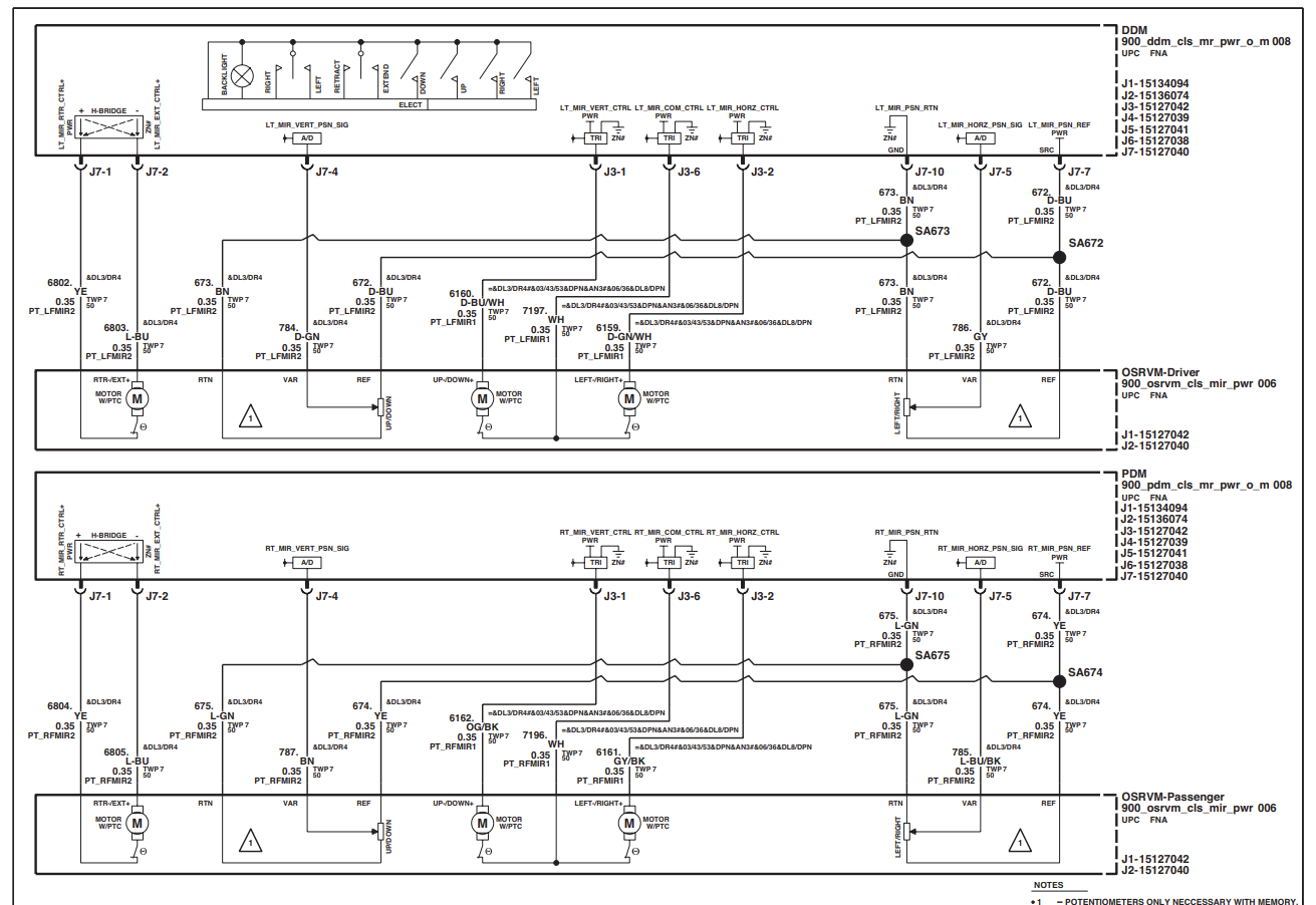

What exactly do the BCM modules monitor? I have a folding mirror motor that’s doing something weird and it’s not showing up in the scans. I’m assuming that there’s some kind torque sensor on that motor that is failing. This is the second replacement motor on this thing. Replaced the drivers side motor at the same time and it’s been perfect. At the point I’ve put two new motors on the passenger side it feels like a truck issue and not a part issue.

mirror motors are a passive component both the adjuster motor and folding motor, you will not get any code for them. either they work or they don't
so looks like time for #3
26,145
39,135
To be clear, I liked your response. But I don’t. -__-
if the adjuster motor is bad and you have a memory function set it could by trying to get to where it is being commanded but can't so it just tries and gives up
and if it is attempting to fold and doesn't then usually the gear on the motor cracked so it may wiggle and give up as well

Not, I think, a memory function. I press the fold out, it does, then tries to overextend twice. Same problem the original had. Folds out. Clack clack. And stops. Fold in. Clack. And stops. First guess is the plastic gear has broken again in the first two months of use, after the first broke in the fist 30 minutes. But the cause… idk.

Looking at diagrams, the side mirrors are powered by their respective door modules.
Even though the BCM maybe commanding it, the door module is doing the work...
Not saying that's the problem, but MAYBE a possibility..

When you say it tries to over extend twice, do you mean it tries to over-extend, then over-retract?
Or does it extend and retract twice?
Anyhow, looking up "PTC" from the diagrams, here is a web explanation...
(I didn't know this before you made me look!)
A PTC resettable fuse, also known as a polymeric positive temperature coefficient (PPTC) device,
is a type of electronic component used to protect circuits from overcurrent conditions.
Overcurrent Protection: When the current exceeds a certain limit, the PTC fuse increases its resistance significantly,
reducing the current flow to protect the circuit.
Resettable: Unlike traditional fuses that need to be replaced after a fault, PTC fuses reset themselves once the fault
is cleared and the device cools down.
