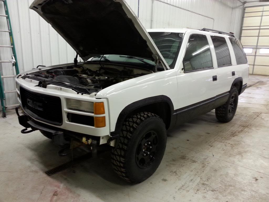

So a couple months ago I decided to Herculine my rocker panels and do a little customizing to the bumpers.
Here is my Yukon when I first got it
Progress

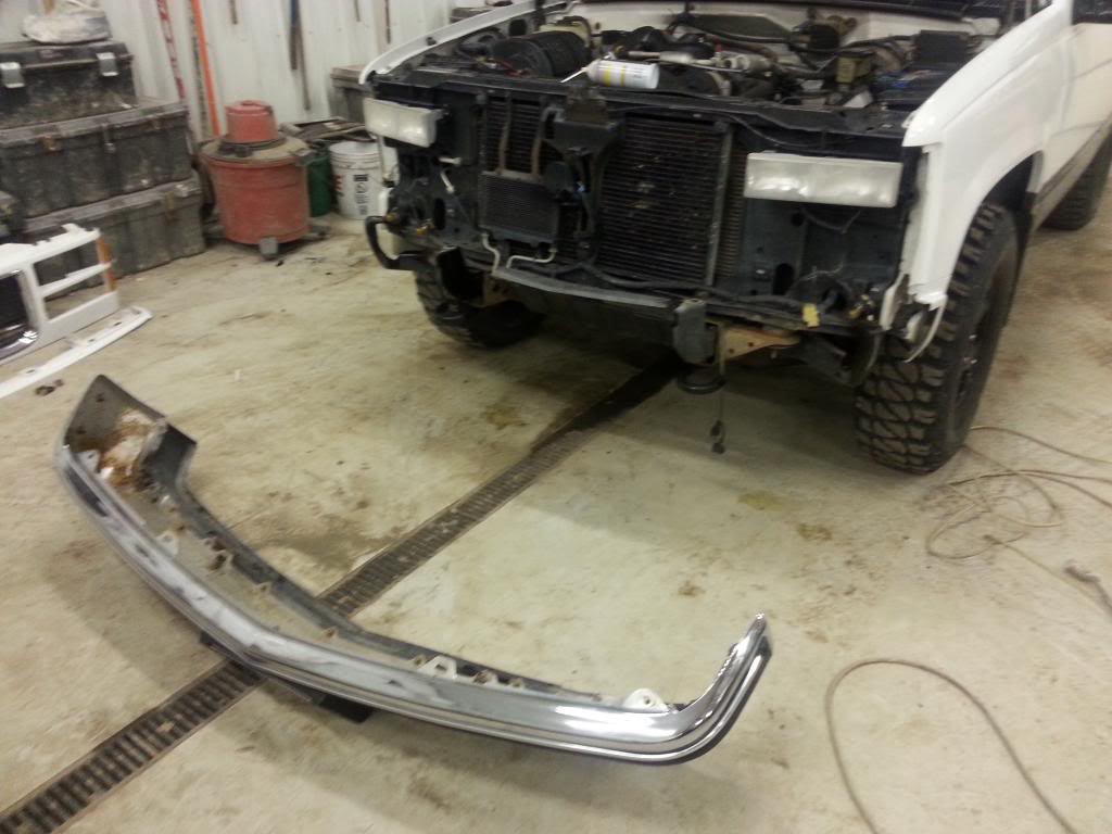

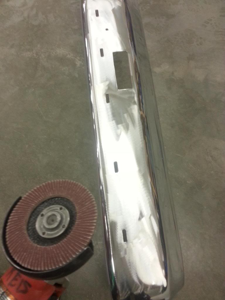

Started with removing the bumpers
Ground the chrome off down to bare metal

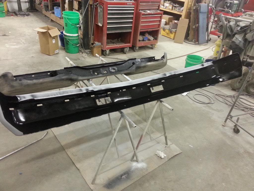

Also cleaned up the inside of the bumpers, took wire wheel and some light sanding and sprayed with rust inhibitor
Primer and than paint

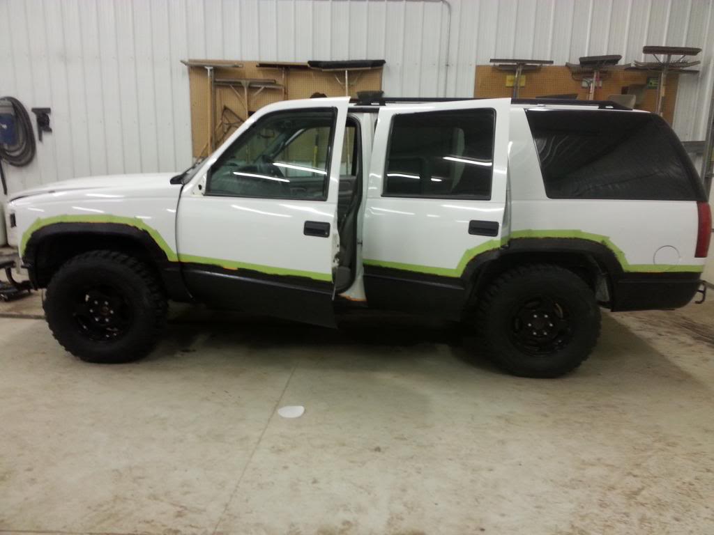

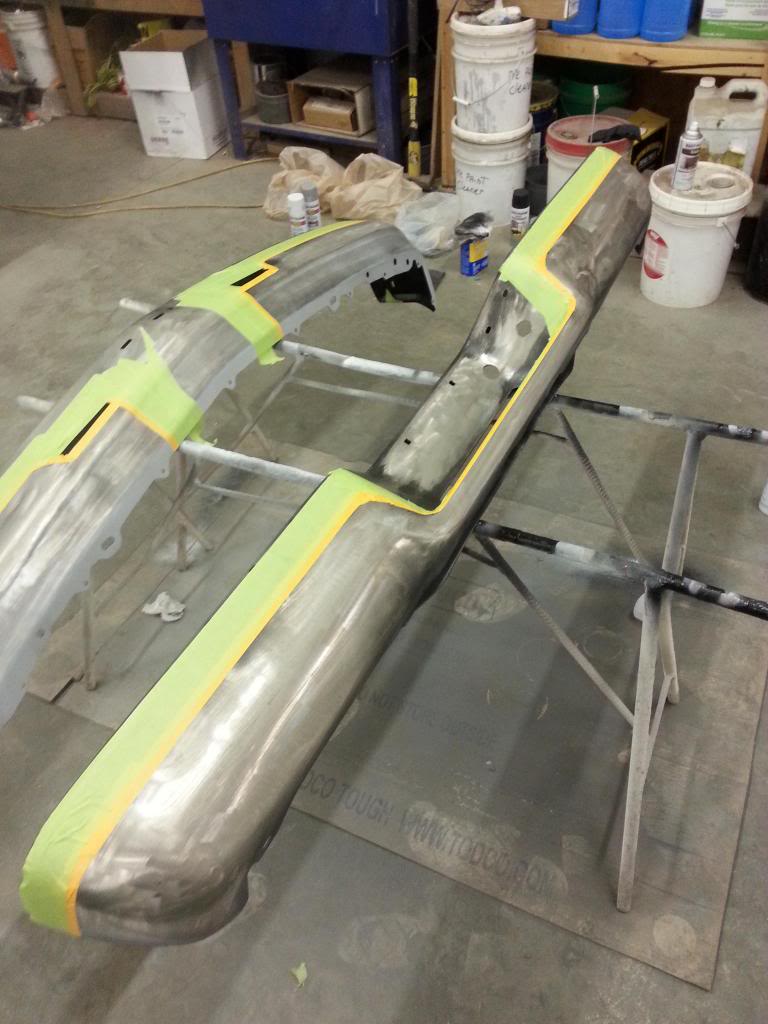

Now for the taping, tape off bumpers where line will be for bedliner meets the paint. And taped off body for herculiner
Primed bumpers and than painted white

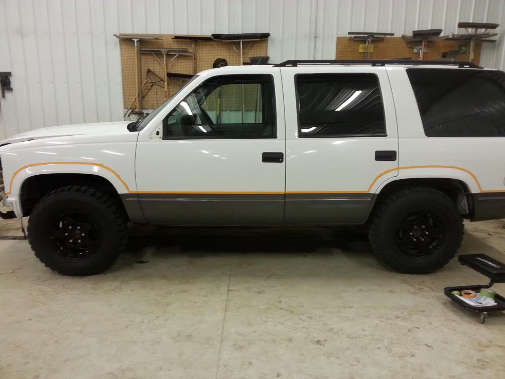

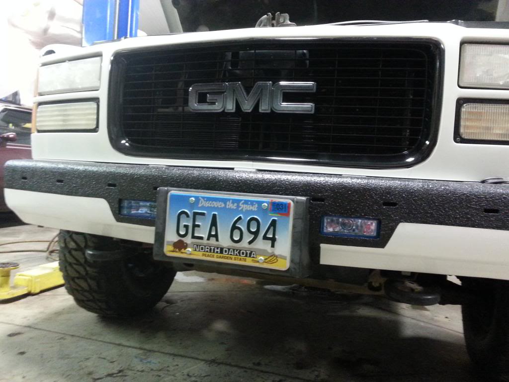

Here is after liner on the body, also did the side mirrors since they were chipped and flaking.
End result
Also cut holes before the liner for fogs, here they are installed.

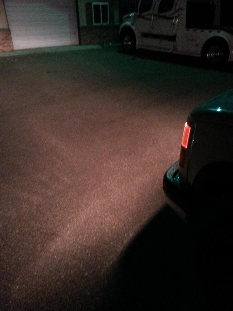

Here is lowbeams without fogs,
And lowbeams with fogs on
Overall I think it turned out great, the hole in the bumpers I am looking for some LED's for semi trucks that will fill them in and light up nice at night.
