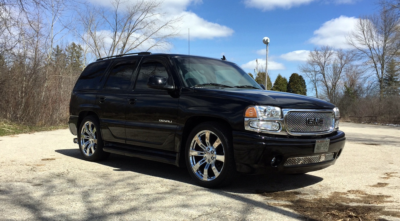

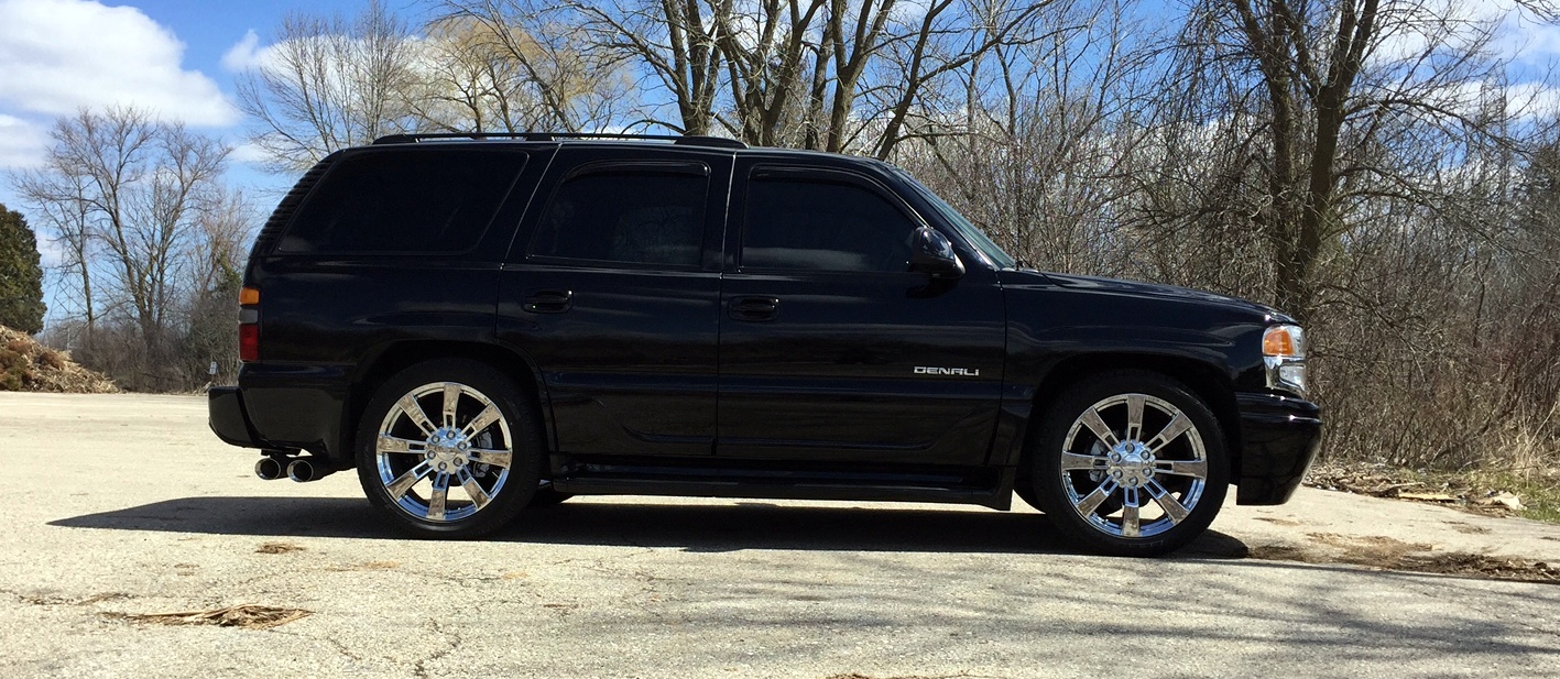

Belltech 2 3/4 Kit Ended up going no spacer so 2/4. Details:
-New Lowering Springs(part of the kit)
-New 2" Drop Spindles(part of the kit)
-New DJM Rear End Links
-New Spohn Adjustable Panhard Bar
-New Axel Bumpstops
-New Shortened Autoride Links
-Completed FREE Travel Mod including grinding/painting
-Added Airlift Helper Bags 60742
Current Measurements(Ground to Fender Lip):
Front : 33 1/2"
Rear: 34"
Sitting on 22 X 9 31mm Offset 375's wrapped in 285/45/22 Bridgestone Duellers
