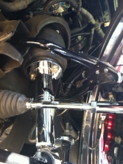

They work great and are adjustable. I had mine chromed :mexsmoke:

ahhhhhhhhh sheeetttttttttttttttttttttttttttttttttt we got chrome belltechs!!!

@Nasty GM Bagged and Chromed. Baller. :licklips:
