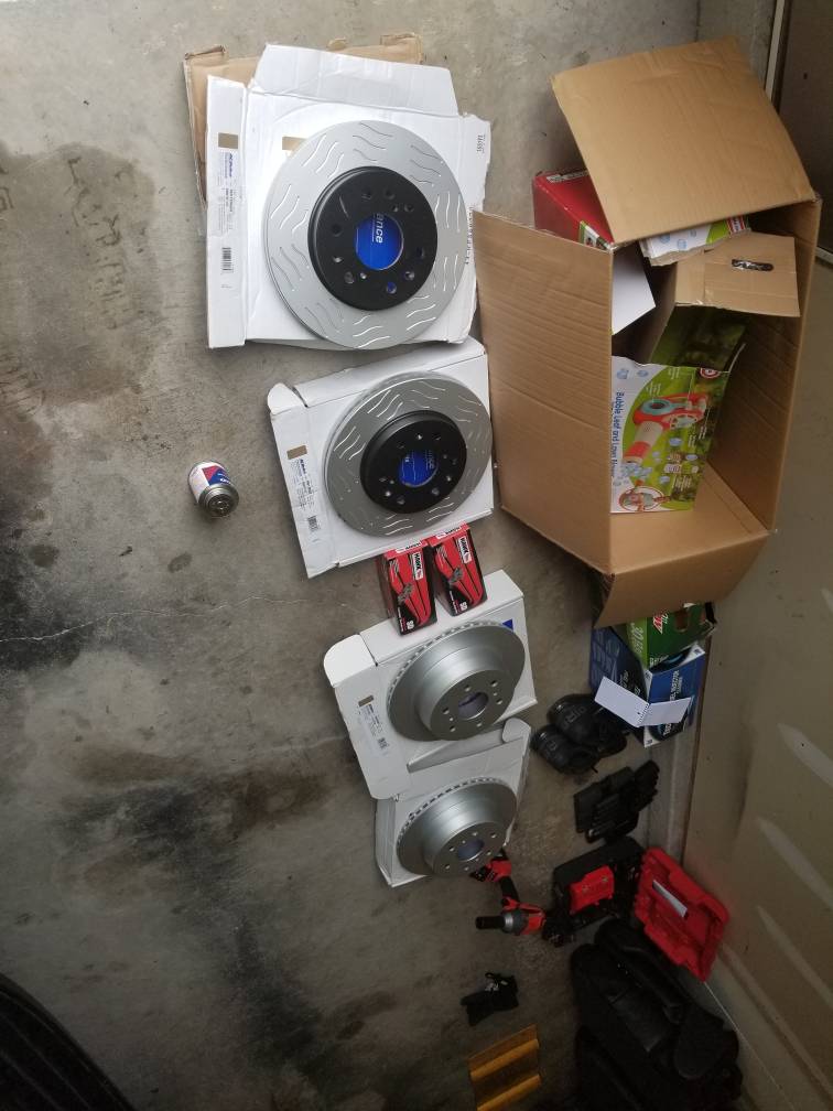

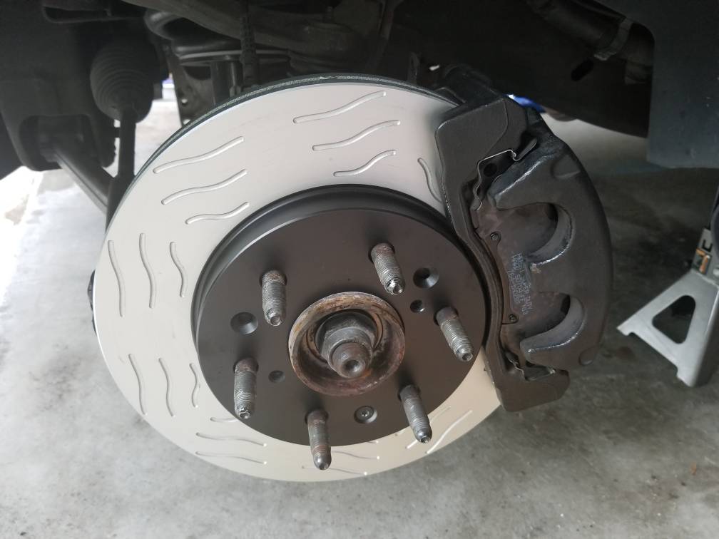

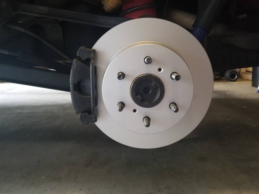

I choose the AC Delco Slotted Performance/ Fleet disc in the front and AC Delco Performance rear rotors combined with Hawk HD pads front and rear for my setup.
Raybestos makes a copy of the front design, but they were more expensive and the vane design of the AC Delco fronts are different for better heat dissipation.
Once beded, they stop! They do have a little squeal upon first tapping the brake occasionally. 00e8a11799b3f112a35011c036471507.jpg6832bb64d074d25c6a17bb6ad8b40b9f.jpg59c784d2b87aad15d6d89c242681cc40.jpge56f7b2fbcdc4af428d9aa4329f55132.jpg60c16fb370718620079e625040a7fdaf.jpg
