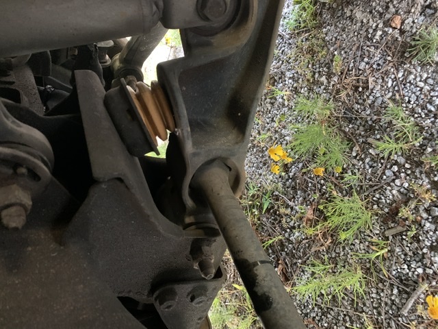

Try and get me a pic of that jounce stop if you can. Thanks, Jason

Part numbers 4922 and 4923 but which one?
You need me to google it for you?
Description: Foam Bump Stop - Universal Cone 2.01" Tall x 2.5" OD
Part #: 4923
UOM: Pair
BUMP STOP KIT
Description: Foam Bump Stop - Universal Cone 1.26" Tall x 2.5" OD
Part #: 4922
