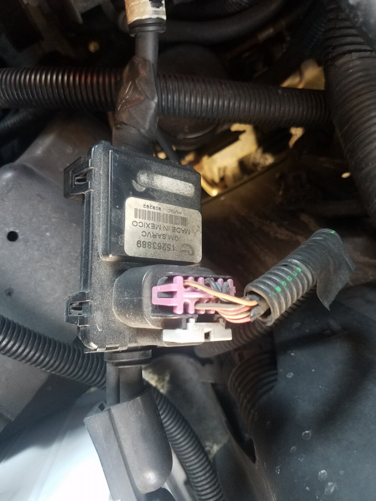

The NBS alternator has an external voltage regulator at the battery clamp starting in 2005.
This might make sense. I wonder if e-fans had anything to do with it?
