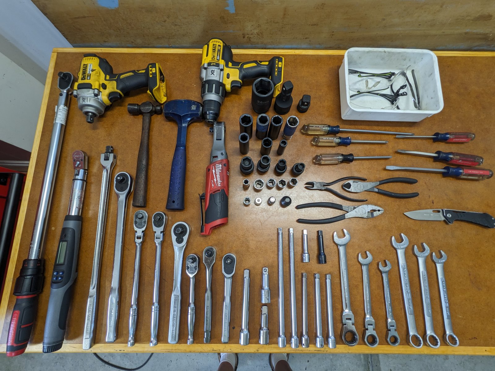

At 195,000 miles I've been doing several of these projects. A couple of weeks ago did engine and transmission mounts. Next week having transfer case rebuilt and back of engine seals replaced to fix oil leaks.

Actually, I had my tranny fail last fall. Not sure what torque converter went in with the reman but is shifting very well.. Eve though it's not a year old, should I consider replacing the converter with a BU60FHD ?
I have a new barbell in the truck for the work next week. I got the idea from posts here on TYF.
BTW, today was an 11.5 hour marathon but got everything done. I'm beat!
Thank you all for your input.
