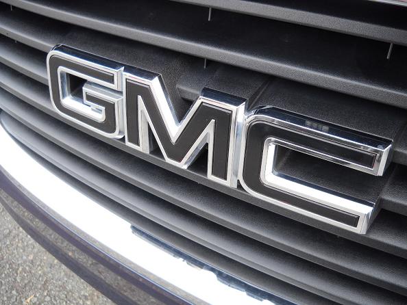

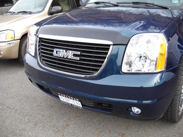

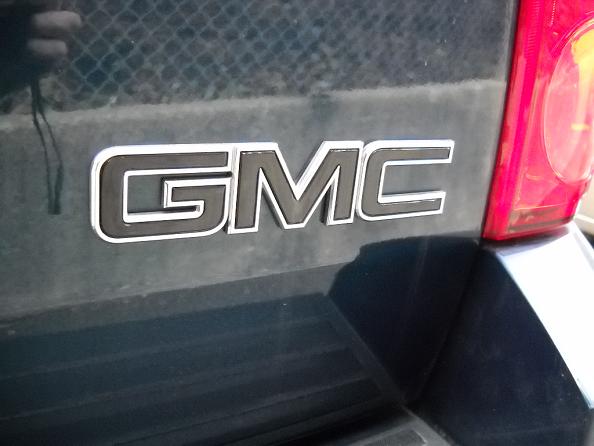

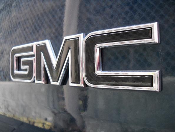

I found a simple solution for this. I have a vehicle wrap/graphics company and i've been wrapping them for ppl. I use scrap vinyl and it comes out great, its not permanent so you can change the color when ever you want. Ive been tryin reflective black and it looks awsome at night.

do you have or would you mind posting some pictures close and far away? that sounds like a really good idea! about how much does it run?
bjc7jr
Jun 9, 2009
127
PA
actually this method might be cheaper than paint if you try to DIY..........and a whole lot less time consuming. I would go to a vinyl shop and see if u can give them a couple bucks for some scrap of what ever color you want to use. Then slowly stick it to the emblem. cut around the edge and then heat with a hair dryer to make it form into place.
