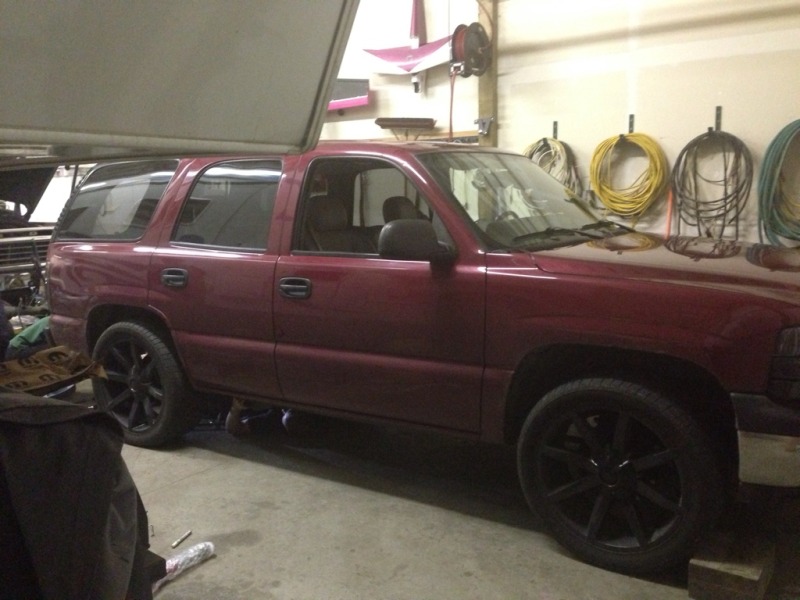

So we got the front axle all buttoned back up for the last time. Rear stainless lines are on and now waiting for brakes to show up this week.
And this is the suspension at full extend. There was enough room with just cutting the bumpstop off the frame now there is plenty of room without the axle bumpstop perch.

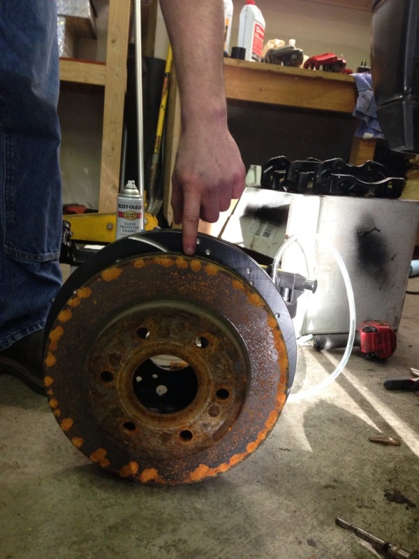

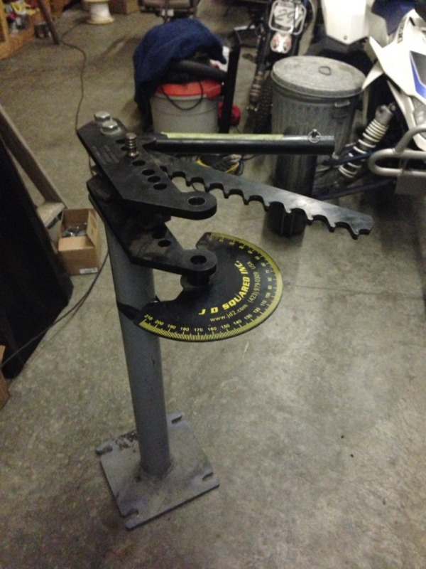

Got rear rotors and new front calipers the other day. Upgrading to GMT900 front calipers pads and rotors. Undercoated the front inner fenders and frame rails. Got StopTech SS front brake lines for the front. Also the next step will be installing Corbeau CR1 race seats along with a full roll cage.

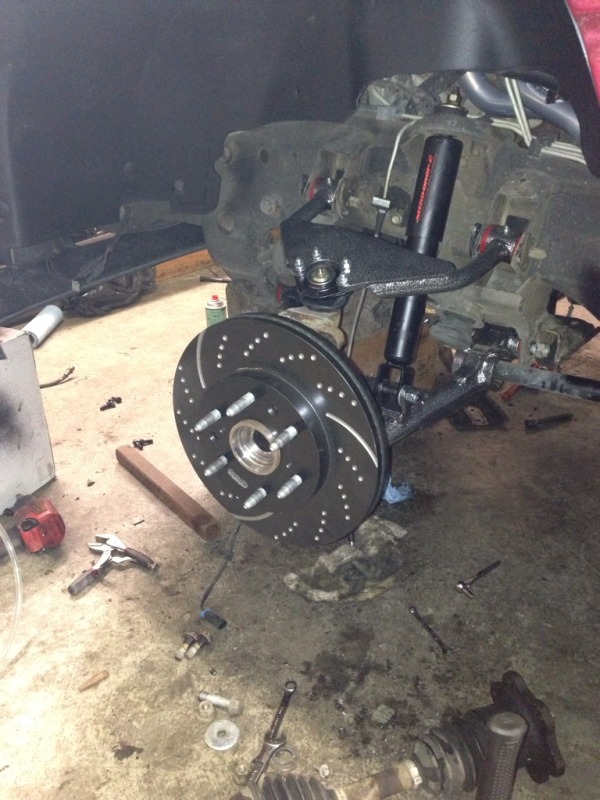

Heres some more pics of the new front cailpers. The 07+ GMT900 setup has 13" front rotors and almost 1" more of surface touching on the brake pads. So it will be an upgrade all by itself but we are putting EBC 3GD slotted rotors and Yellow stuff 4000 kevlar pads on it.
and StopTech SS front lines

Have to wait until next week for seat brackets but in the mean time we test fitted the seats. Race mode anyone?
