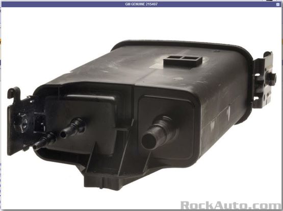

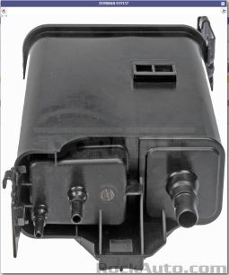

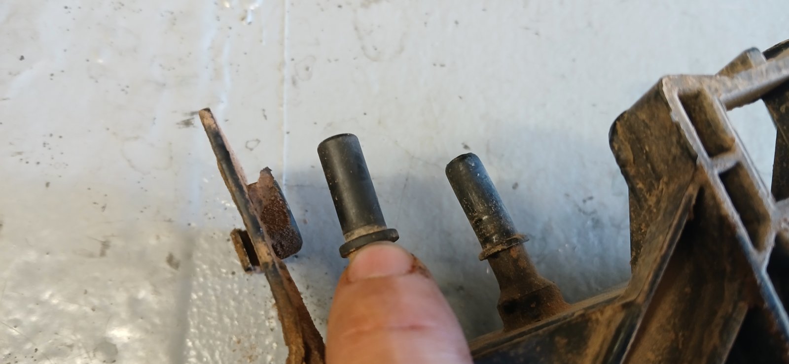

All fuel lines are good. The evap crap just crumbled in the hand though *sigh*. The lines are perfect but the QD's are shot. Can you buy just the QD ends for the evap lines? I was going to pickup all lines at junkyard. They're a bloody fortune new :( I'd delete the evap system before I put new lines on. It'd be several hundred bucks. At least when I last checked RockAuto.
The first is the vent for the evap canister. One of the tabs broke off the QD. The other is still there.
The second is a complete nipple on the evap canister it broke off in the QD. I need to get another canister now. (I think I will just pull a couple at junkyard and test them).
Lastly, the big line from the tank? The QD complete came off trying to remove the canister to test it. UG.

Interesting experience. I went to the junkyard, pulled all the evaporative lines and looked for another evap. Only found one and it was broken same way as mine. I spoke with one of the junkyard dudes that super smart with this stuff. He told me how to fix mine and they gave me the old evap lines I pulled to fiddle with and fix.
I took the broken off fitting from the canister... reinforced it with a straw on inside diameter, glued it together with super glue on inside, then JB weld on outside. He said to then take string and reinforce the outside diameter where crack / JB weld was placed before JB weld sets up. I did that and it setup solid as a rock. If necessary I was going to clean the inside diameter with a drill bit but it didn't clog during glue process.
Then he said to take the evap lines, get the replacement Quick disconnect fittings... Heat the old hose by the fittings with a blow dryer (or heat gun) and it will expand... the old QD fittings come right out and new ones slight right in.
