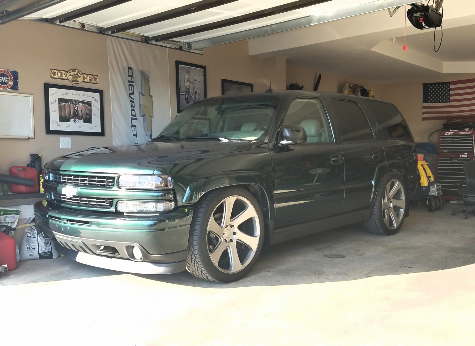

Today I decided to see if I could figure out how to make this Offroad package more street-ish.. So I picked up some vinyl rain gutters at Lowes for $6 each (10 feet) and whipped out the heat gun.
Here are the photos of the outcome of about 30 minutes of work with them.
Pulled the side steps
Mock up/test fit
and shaped to fit the contour of the Z71 plastics.
Now I need to plastic weld the edge up and possibly run a filler along the seam, rough everything up and, for the mean time, hit it with some spray on bedliner. Hopefully I can get some of this done this weekend, but we will see...

I'm pleased. Color match with a satin clear and it'll be perfect!

Damn thought it would be a small difference but turned out to be a big difference.looks killer!!

Wow! That is not what I expected when I saw gutters and ....haha well it looks pretty damn good!
Creative and functional.

There's still a little work I have to do to clean it up, but it's getting there. MUCH happier with the way this thing looks with the darker front air dam and side skirts instead of the steps. Also blacked out the plastics on the rear bumper.
Used some of that crappy Rustoleum truck bed liner that comes in a spray can from Autozone. It worked pretty well lol. Plus, it will be a good base layer when I eventually lay down the color matched green.
Still have to do the passenger side.
I also have a lower bumper extension on the way, picked up for $34 from rock auto. This will line the bottom of the front bumper with the bottom of the skirts. Annoys the hell out of me that they are uneven.
And surprisingly, a "new" front bumper (used but in good condition) is hard to find locally for a decent price. All of them are outside my travel time windows that I currently have and my rusty, cancered front metal section annoys me.
