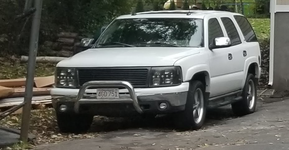

Bought a '03 Tahoe LT with 235k miles for $2k, time to fix it up!

Aside form seepage from the valve covers, it's pretty dry above the oil pan. I'm hoping this resolves the leak. There was a ton of cleaning so I haven't installed the oil pan yet, but I plan to do that today. I'm really hoping this was the only source of oil leaks. I will post more pics after I get the oil pan back on.
The next items on the list include:
- Wheel bearing assemblies, brake pads, and rotors
- A/C belt replacement and add refrigerant with UV dye
- Evap system diagnose and repair
- Valve cover gaskets
- Replace oil pressure sensor, as well as air intake manifold gaskets and possibly knock sensors while I'm in there.
There will surely be other things to do, but those are the next items on the to-do list.
