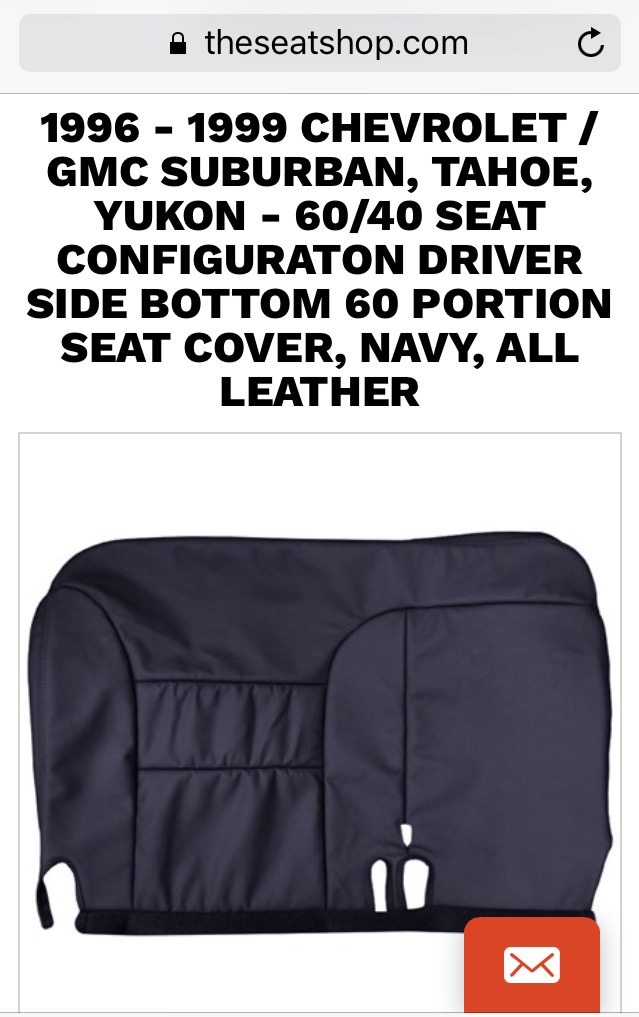

not sure if i missed something lol but its been a fun past few weeks. looking for someone to reupholster the drivers seat. its a bench seat with blue leather and its impossible to find a seat cover or even a used one on ebay.
