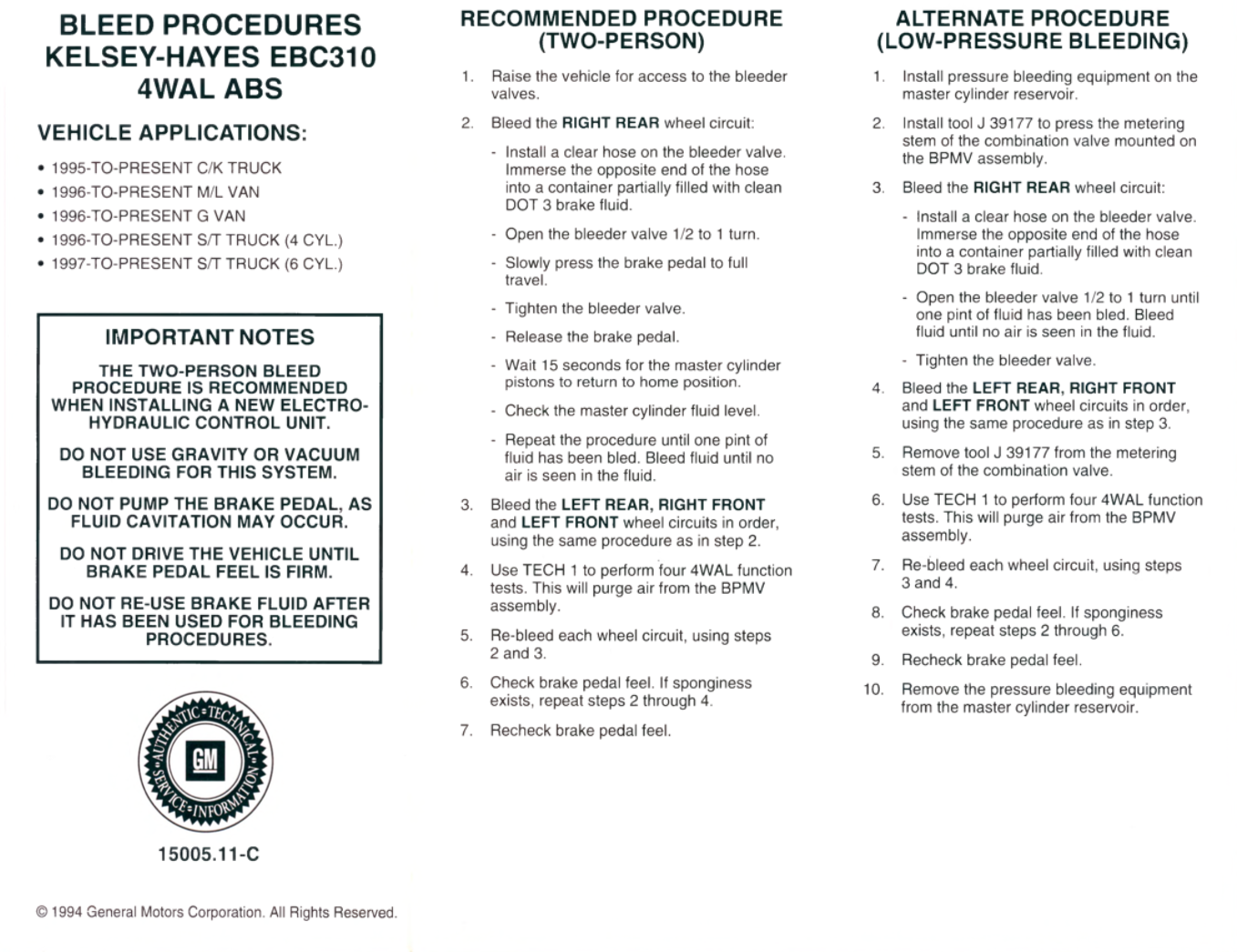

Are you going all the way to the floor with the pedal? Try half strokes for one complete bleed sequence. I know it sounds impossible but try it and see, In fact since you feel the rears are the issue just do those and leave the fronts alone. ill bet the pedal firms up instantly. This is a big hail mary bet!

Thanks for the reply/advice. I don't push the pedal all the way to the floor any more. I killed at least one MC doing that the last time I went through this. Probably about 1/2 way or so.
I only had about a quart fluid left so I just put it through. I got a couple bubbles from the passenger rear. Not sure about the rest as it's hard to tell when you're one man bleeding. About to return the spare MC to Autozone so I'll see if it's any different shortly.

Considerably better. Pedal was going past halfway. Now probably travels about half of what it did before. Finally got somewhere. And that is why I wanted to set the ABS off.
