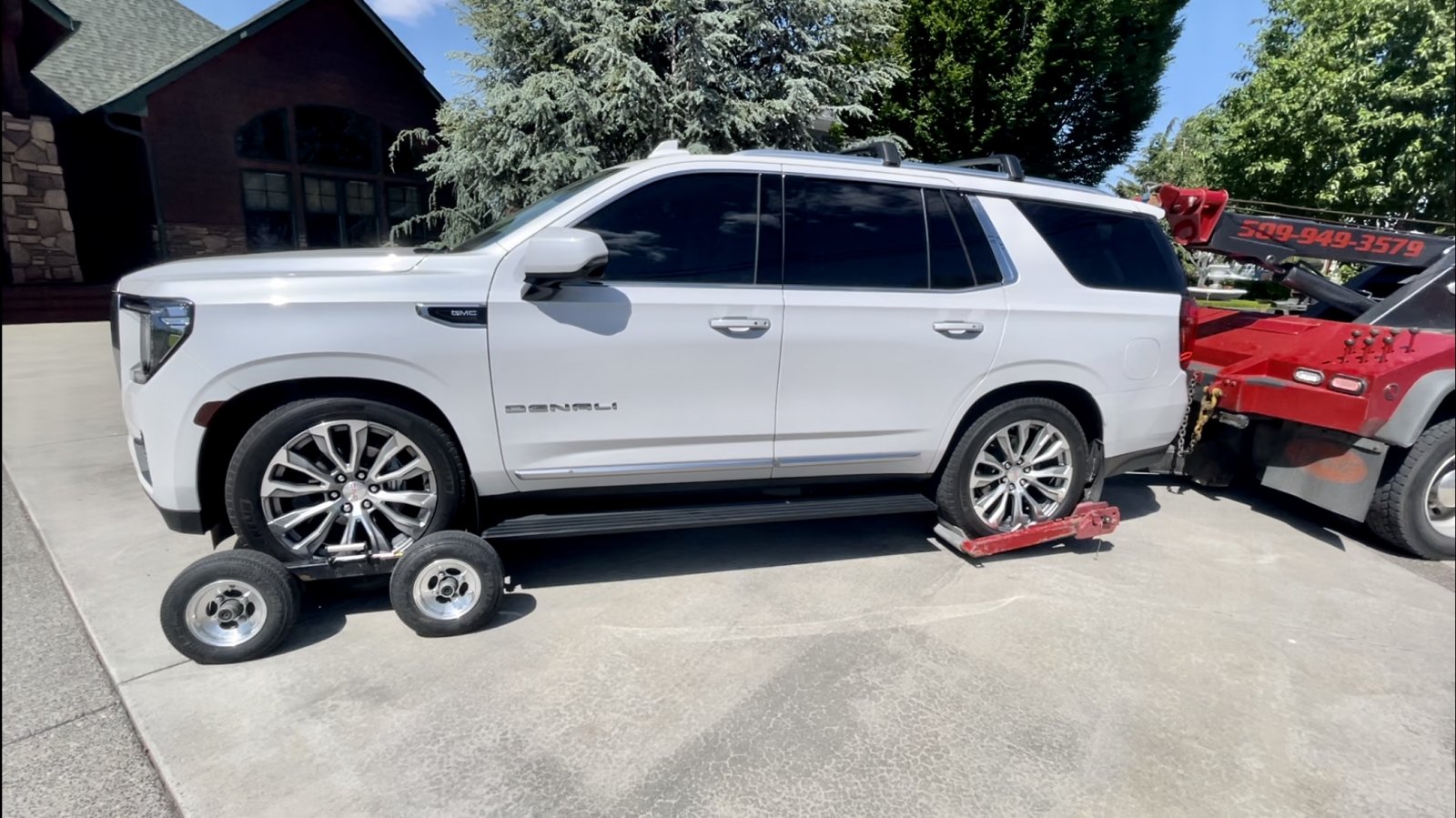

Add me to the OTA bricked list. Parked in the garage at home on Saturday and approved the update at shut down, I have auto lock enabled and I heard it lock and chirp as I walked away. Came out the next day and the Yukon was unlocked and completely dead, no interior lights, no start. I put it on a battery charger through the next morning and it never took the the charge. Called the dealer this morning (Monday) and the advisor said I wasn't the first call with this, he asked if I could call roadside and they would be expecting it.
Roadside assigned the tow company and as soon as I got a confirmation text I called them to say I've got a tile floor in my garage with a rubber threshold, thus was very uneasy about it being dragged out. They sent a truck with a dolly and the driver was awesome, incredibly careful. You'll see in the pics he even put down plastic furniture moving sliding pads under his equipment so he wouldn't scratch my floor as he put pressure on them, the tow company was great.
As I said above it put my Yukon into an unlocked state, so consider that next time you do an update in a store parking lot or somewhere unattended. If I do another OTA it will be in the driveway at home.

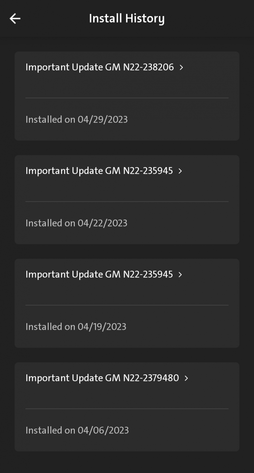

Anyone that has had this happen know the update # that it was trying to install when it bricked itself? Wondering if there’s a common denominator here…
Eusibius2
Oct 3, 2021
212
146
Chicago burbs
Here's a list of what I've installed OTA, from the Chevy app. Hopefully none of these are creating this problem but would be great to know what is..
