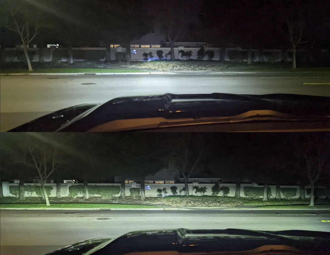

you can get some incredible add-on fog light/driving light output with some diode dynamics SS3 "max" they are not cheap a set runs about $550 but they are worth it.
they are a true fog wide-angle light as shown below no fog, then with fogs
the upper shot is d5s 6k & 50w ballast's, then the lower shot is + the ss3 max
