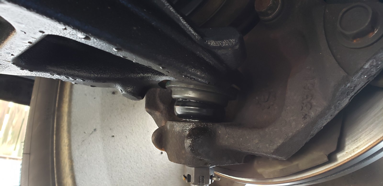

I was able to get the broken grease fitting out.
Got a new one on there.
I go to put in the grease, and the grease started flying out the bottom. When I did the others, you could see the boot swelling and then eventually some would ooze out.
I am thinking the damn boot is torn and I am going to have to replace the arm anyway. So annoying!
I hope I am wrong. I think I am just gonna roll with it and see what happens. Maybe the boot just got put "into place" from the driving and this is how it's really supposed to work.

You can get replacement boots for them instead of the whole arm or another ball joint.
When you replaced the grease fitting did you just push the axle back for room or did you separate the spindle/knuckle from the arm? If you did separate, you could have damaged that boot, like you think it is.

I pulled the axle and strut off, did not remove anything on the knuckle. I'll try to snap a pic

Don't forget to align the front end when all done. If that boot is split and you did not do it then you got a new part with a split boot and a broken grease fitting. Did you close inspect to make sure was not a pre-installed part?

Maybe the boot popped off the ball joint???
Good call. The boot should have a rubber covered metal ring inside there at the lip and you have to push it down, all around, to seat it properly. If you find it that way you will want to be sure that where you push it back down and seat it on the ball joint, that surface lip of joint should be dry and the inner edge of the boot as well, so they GRIP each other. If is greasy then it will slip off again.

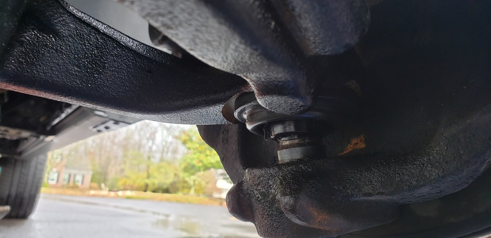

I think it's correct, the other side just didn't ooze the grease out yet. You can see on the right side, there won't be much room for grease.

I just got carried way on the passenger side, hopefully that tension releases soon. Either that, or the passenger side is a different design.
